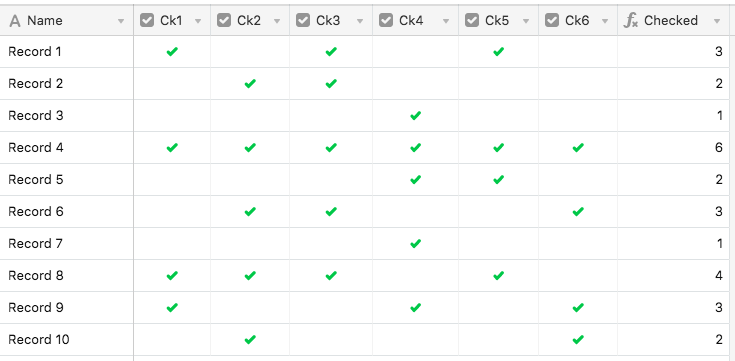

Here’s an example. I’ve got ten records with six checkboxes each, with the fields named {Ck1} through {Ck6}.
The last field is a formula that concatenates the string equivalents of all the checkboxes (a check returns “TRUE”, while no check returns nothing), uses SUBSTITUTE to turn each “TRUE” into “T”, then counts the string length.
LEN(SUBSTITUTE(Ck1 & Ck2 & Ck3 & Ck4 & Ck5 & Ck6, "TRUE", "T"))

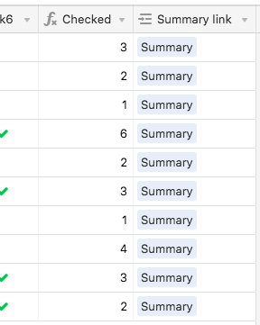

I’ll add a link field at the end, with all records pointing to the same record in another table:

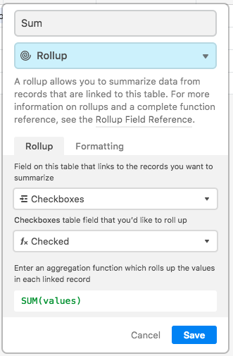

In that summary record, I’ll roll up the sum of all values in the {Checked} field from my main table:

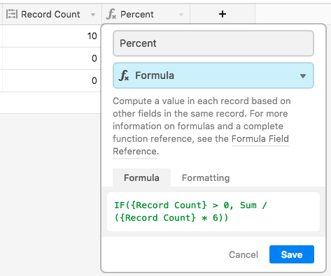

Next I’ll add a Count field type to count the linked records, then use that in a formula to determine the final percentage:
