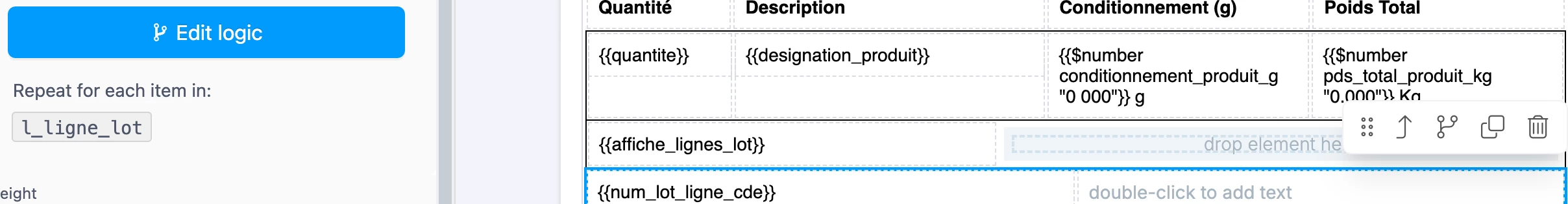

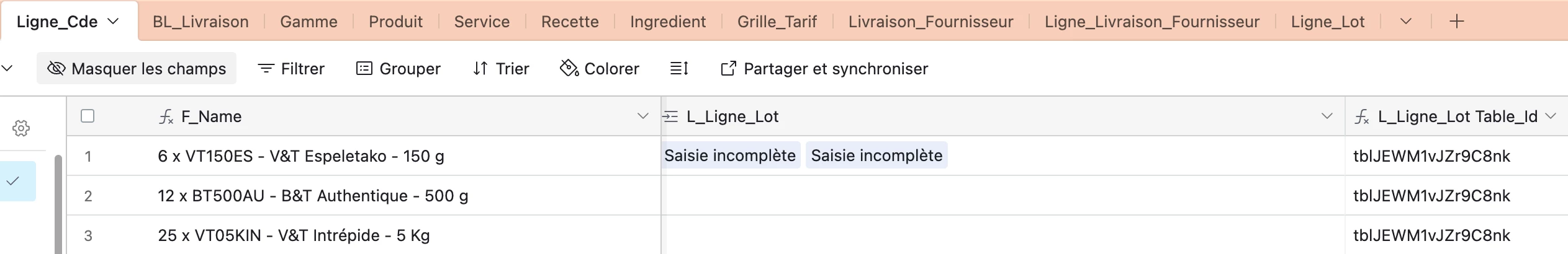

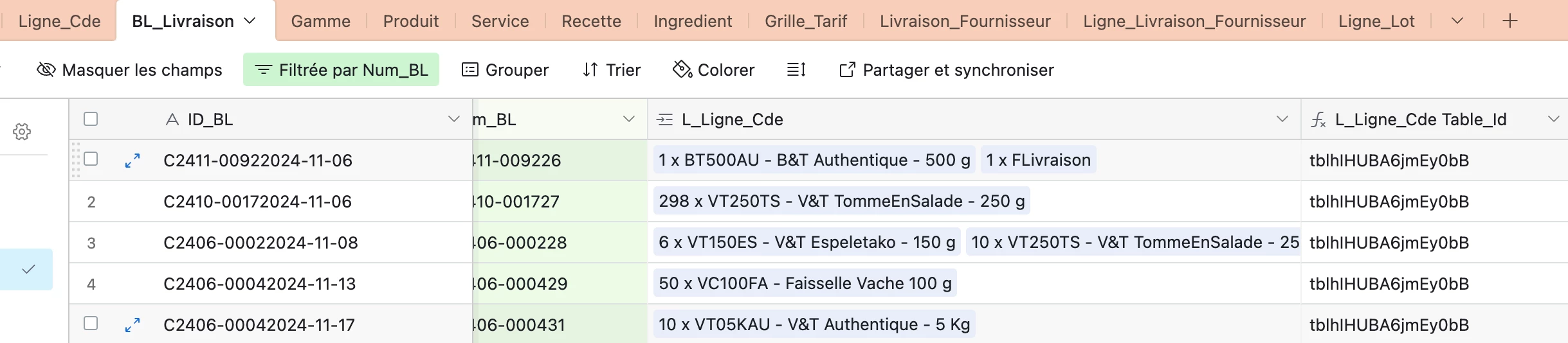

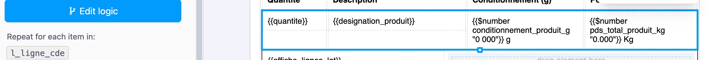

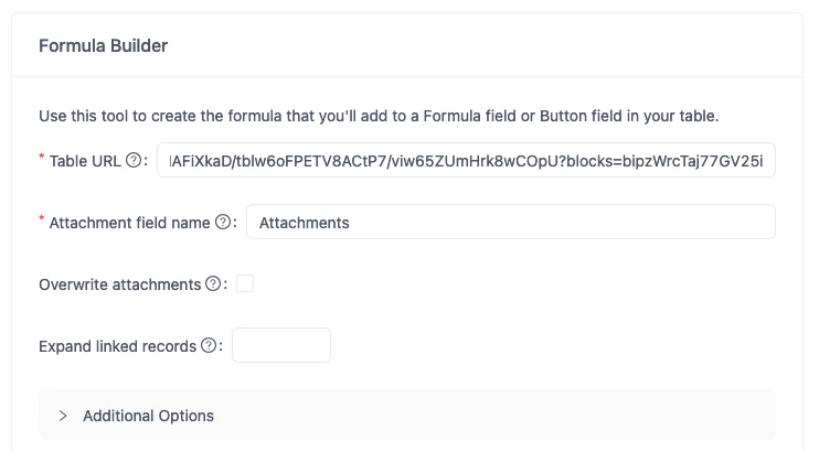

Hello,
I'm able to retrieve AIRTABLE data from a first table as well as fields from a table linked to the first one, but the level below doesn't seem to work.
As indicated in the documentation and the explanatory video on DOCUMINT, as for the first linked table, I create an Fx field named “Lien_Table3 Table_Id” with the value “TableID”.
On DOCUMINT, I indicate the Repeat / Loop on each “Lien_Table3” record.
On the PDF generation link, I indicate “...expand=2...”.
But no display of the desired field.
What could be wrong?
Is there a level limitation with the free version of Documint?
Thanks for your help!

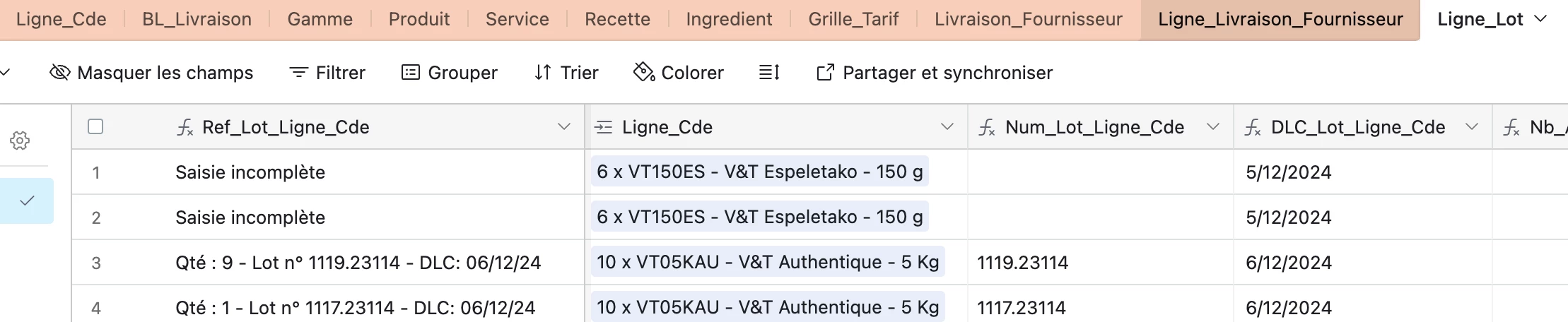

Hello and thank you for your reply.
With a linked operation on 1 level, like the example you suggest, it also works very well for me.
My problem is to continue going down a level with a 3rd linked table.
This no longer works.
In my example (below), the rows: {{num_lot_line_cde}}
are not displayed in the generated PDF.

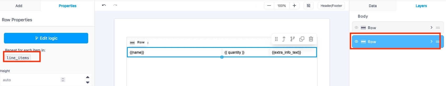

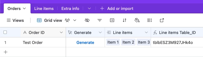

Hmm, yeah could you try moving {{affich_lignes_lot}} into the same row, and then setting the repeat logic for the entire row itself?  I'd also suggest opening a support ticket with them directly and providing them a link to your template, as well as a read only invite link to your base; with direct access to both things they're going to be able to get you fixed up pretty quick!

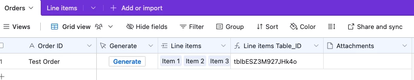

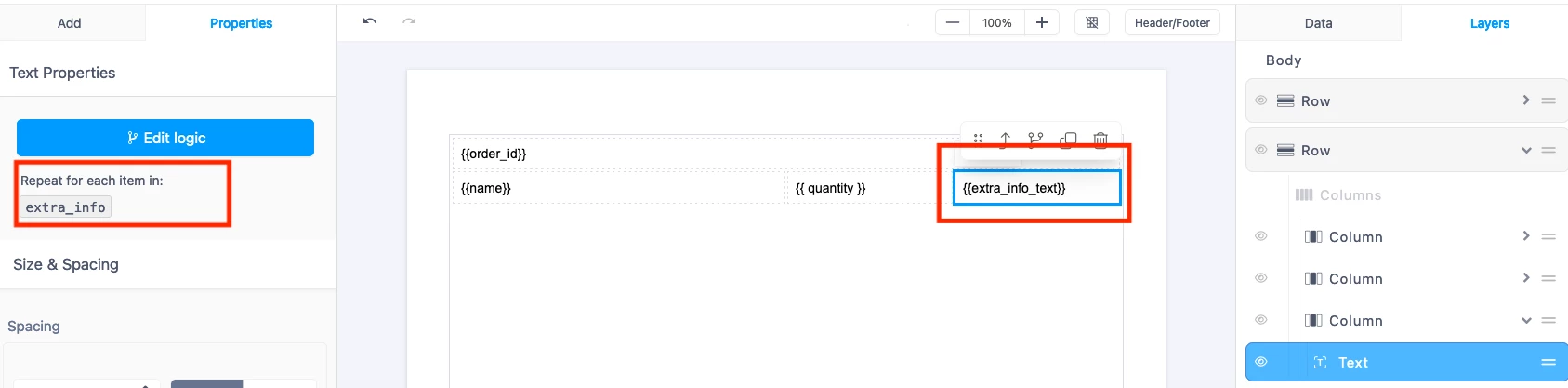

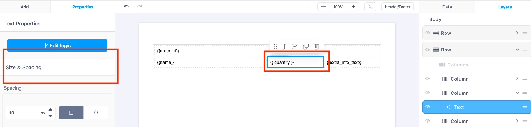

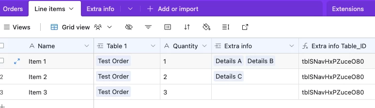

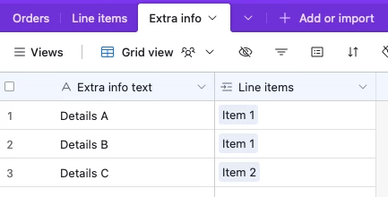

As an example, here's how my data's setup where I created a third table called "Extra Info"
The entire row has the repeat logic here:
And the third table's field is inside that row, and has its own repeat logic:
Note how the field that loops in "Line Items" doesn't have a repeat logic setup:

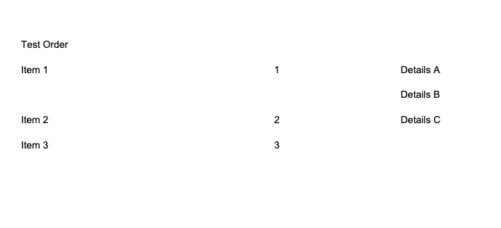

And here's the final PDF:

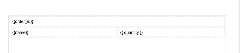

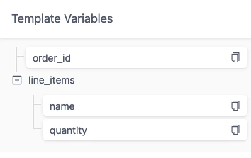

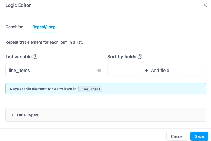

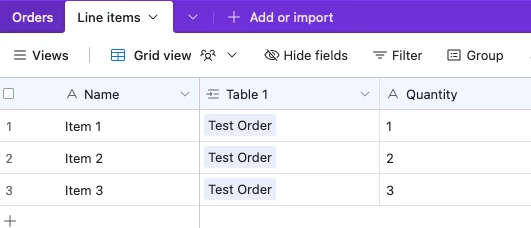

If it helps, here's a very simple version that's working: Link to base
Template variables on Documint:
Each element's logic editor: 
Link setup:
Doc setup:
Generated PDF from button:

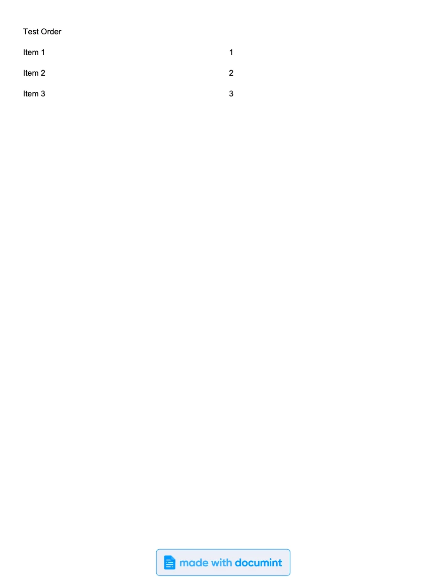

Link to base

Indeed, your solution works!
It was indeed a problem with the Repeat/Loop declaration in the wrong place.
Bravo and thank you very much for your help.

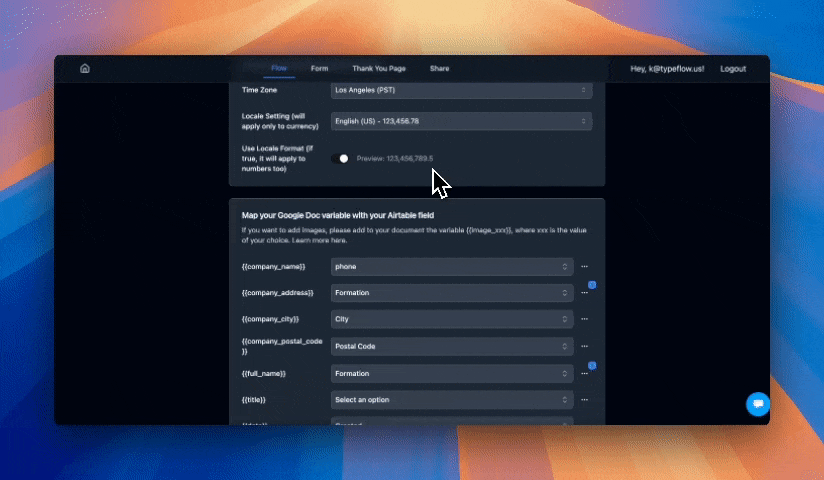

Hello,
Just to let you know, with Typeflow.us you don’t need to implement those hacks. Indeed, creating fields to get access to data from another table isn’t the best approach. If you need to build those hacks many times, for each PDF, you table can be clunky over the long term.
That’s why at Typeflow.us, we implement a way to keep your table clean.
  1. Pick a linked record field
  2. Go to option (three dots on the right)
  3. Configure Linked Field
  4. Select the field from your Linked record. No need to create a rollup field
  5. If you want to go at a deeper level, you need to select another linked record
  6. Automatically it will return all the field from this other table.
Thanks to that flow we avoid you to build rollup fields, and all the unecessary fields just to generate PDFs.
PS: Typeflow.us is a software to generate PDF based on Airtable data.
