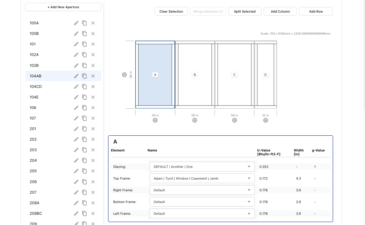

Context: For some things we have found that is SOOOooo much easier to work with graphical widgets rather than tabular data. Not all things, but some things. For instance: I have built us a ‘window builder’ which allows us to graphically create windows, and then assign the data for glazing and frame types from our AT material collections.
While we *CAN* (and did) used to do this in tables within AT, having the picture just makes it so much easier to see what we’re doing, and trouble-shoot (which frame goes to which edge, etc...).

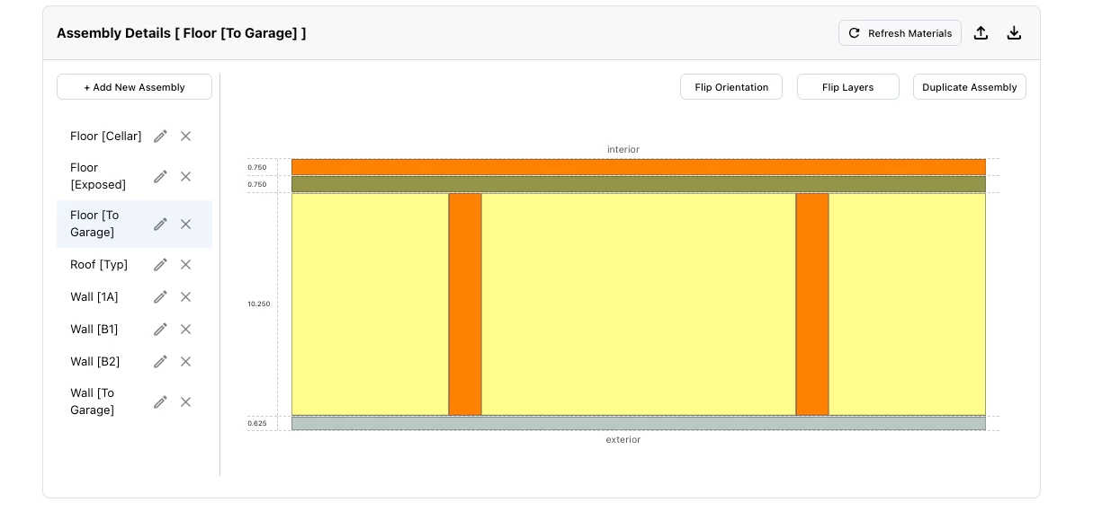

We do similar things with ‘assemblies’ (layers of materials, organized graphically but connected to a backend of  material data in AT).

As an aside, that UI looks really clean and similar to the Airtable stuff, nice work man.  After you port it over new users will just assume that it’s part of Airtable’s core functionality heh
