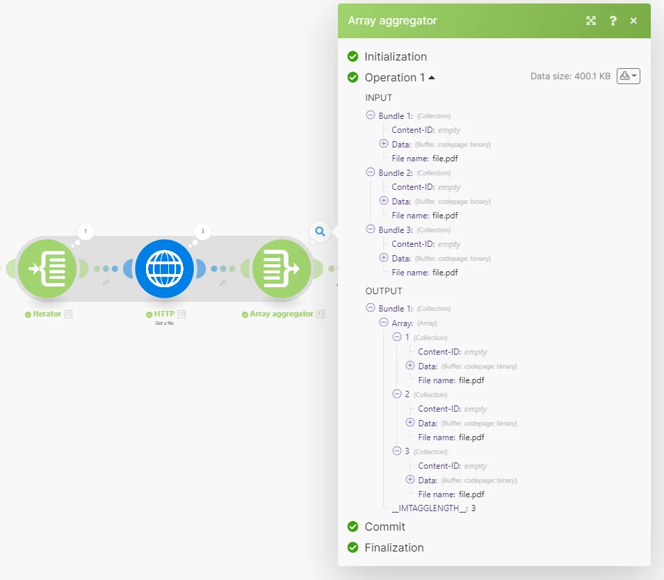

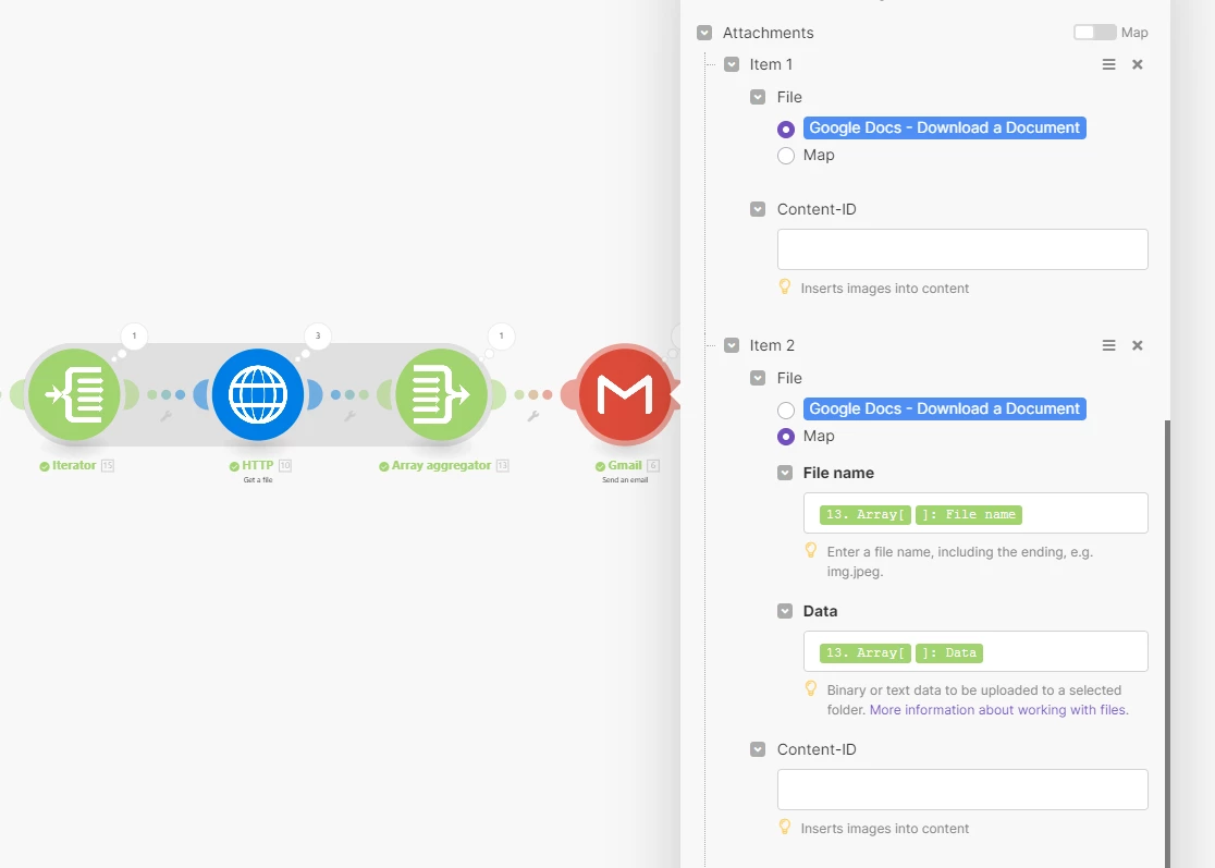

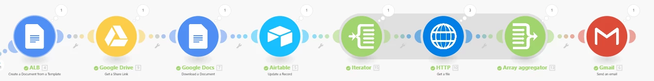

This feels quite complicated for what I thought would be a straight forward process.
  1. Create a Google Doc from template.
  2. Create a share link to attach to the Airtable record, the “download document”-step doesn’t work for Airtable.
  3. Download a document as PDF to attach to Gmail. Neither step 1’s export/PDF link nor step 2’s share link work for Gmail.
  4. Update the record with the attachment and load existing other attachments.
  5. Iterate through the attachment field records.
  6. Download attachments. Here I’m lost how to set filenames, it’s all file.pdf…
  7. Array aggregate with target structure attachments.
  8. Send email. Here I can’t figure out how to attach multiple, it’s either one attachment only or one email for each…
