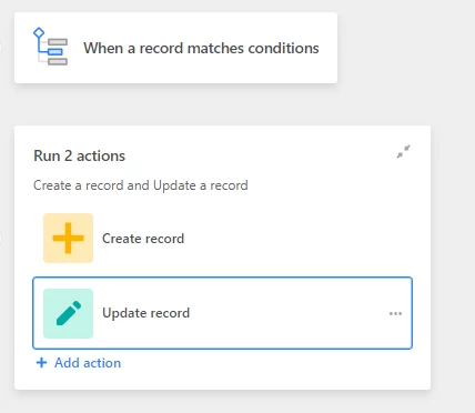

Hi Haley. If I have understood you correctly, setting a certain status in the dealflow table will trigger the creation of a record in the task flow table and reset the status of that record in the dealflow table to something new? Does your automation look anything like the first screen shot below?

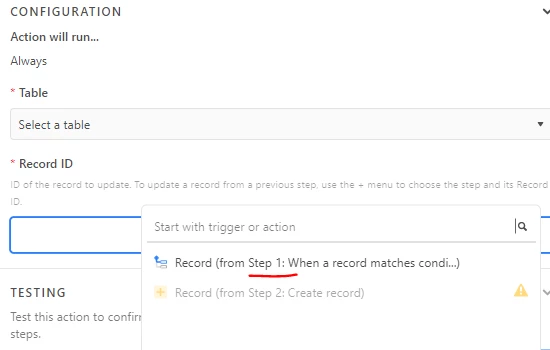

The trigger is primarily focused on the status of dealflow records (and any other fields you might not want to be empty or something). The first action creates a new record in your task flow table and sets fields appropriately, including task flow status. Then, the update record action sets the status of the triggering record in dealflow (select the record id from the step 1 record).

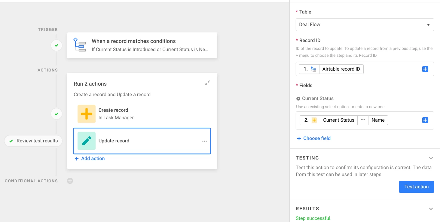

Thank you!! This was very helpful as I was missing the update record action, which is so obvious now you’ve said! However, I’ve now put that in place, testing was successful but my deal flow status still does not update when it is changed in the task flow table. I have it set up like this…
If I did want to look up deal flow status from the task flow table, how would I go about setting that up please?
