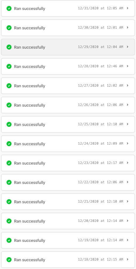

Why only approximately? This has to do with how frequently NOW() is refreshed. There have been discussions elsewhere in the forum about this, but long story short, it varies. :slightly_smiling_face: Here’s a screenshot showing the most recent runs of this daily automation that I mentioned above (click to enlarge):
I’m fine with the fluctuation because my automation isn’t time-sensitive. Whether or not that variance will work for you is something only you can determine.
