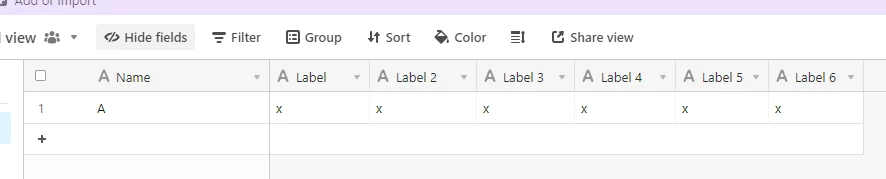

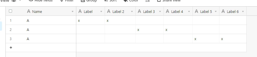

Hi Everyone,
Is there an automated way to combine 3 lines into one?
The context is that, we will have 3 different persons filling in 3 different forms to feed into the same table, but want to combine them into a single line.
Dedupe is OK but we will need to do this 1800 times :frowning: And of course, there are a lot more columns than shown above.
Thanks.

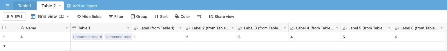

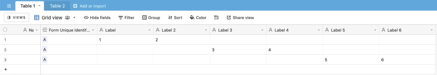

Hey Nick, if each form has a unique identifier, then you could set it up so that each form submission gets linked to a single record in another table, and then create lookup fields to display everything nicely? Nice thing is that it’d work for your historical data too
Adam, that’s exactly what I was after. Thank you!
