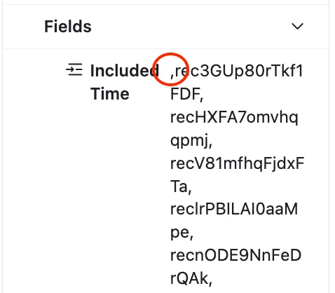

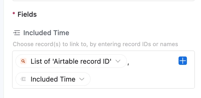

Hmm.. It appears that this comma-separated method may not work if you're trying to append a list, rather than a single record, say, the results from a “Find records” action joined with the original list of linked records.
In my case, I'm trying to merge Timesheet Entries coming from multiple Task records and link them all to a single Invoice Line Item record. My setup may admittedly be more complicated than it needs to be — I'm still iterating — but the principle should work, in theory.
The value I'm trying to add to the linked record field in the Invoice Line Item is:
`List of Airtable record ID's (Find action results), Same Linked Record field (another list of record ID's)`
The error I keep getting is that the linked record field “cannot accept the provided value: Could not find matching rows for string.” And the output value shows a lone comma at the start of the field (from an empty Find result), followed by the comma-separated list of record ID’s that were already present.
Unless I'm missing something, this suggests that, as ​@kuovonne stated, there may need to be a conditional step in here to handle empty fields. Unfortunately in this case, you'd need both Repeat and Conditional logic blocks — to loop through each Task and get its time entries, then for each resulting list, if it's empty, ignore, but otherwise append — and Airtable doesn't currently allow you to do both using the drag-and-drop automation editor.
