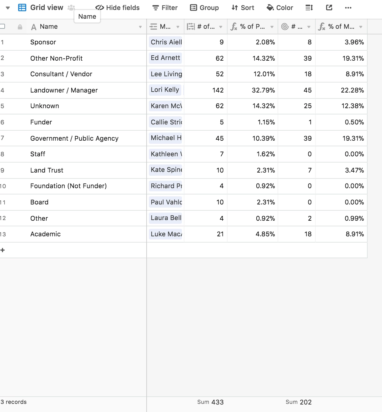

So I was able to write out a simple formula in a table to see what percentage of the people in that row participated out of the total number of people in the table, but I had to manually enter the total number of people - the formula looks like this - ({# of Participants}/433)*100
It works, but the issue is that every time we have more participants, I’ll need to update the 433 number. How can I get this to update automatically every time a new person is added to the total?

That is where the number is coming from, from the sum at the bottom. There isn’t a {total people} field because this is counting from another table. Are the screenshots enough to help?

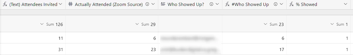

Yes, does seem to be a simple question, but I'm not seeing what I'd think would be right for my case, either:
For my issue, I have #invited, #who showed up, and calculation of %showed up.  Simple math but apparently, not the case LOL.
