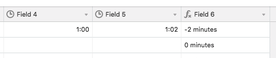

This is pretty simple, but you have to just keep in mind that a “Duration” field holds its value in seconds.
So if you have a duration field, and you enter 1:00 in it to represent 1 hour, and then you create a formula field that just returns the value of that duration field, you’ll find that the formula field returns 3600 - because there are 3600 seconds in an hour.
The implication is that if you have two duration fields (Expected and Actual), and you subtract one from the other in a formula field, you need to divide the result by 3600 if you want it to return in hours; or by 60 if you want it to return in minutes.
When Expected = 1:00
And Actual = 1:02
Difference =
({Expected} - {Actual})/60 & " minutes"
will return -2 minutes
(Seeing the reply that was just sent in above mine, it becomes evident that you weren’t talking about duration fields… maybe someone will still find this useful anyhow :grinning_face_with_smiling_eyes: )
