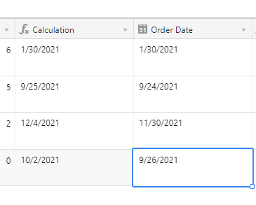

Works fine for me. Here are some examples.
  • Dec 22, 2021 9:22 PM UTC
Right you are!
I must have hit some strangeness or typed it wrong when I tried it. Re-doing it now worked for me as well. Your formula is way more elegant!
