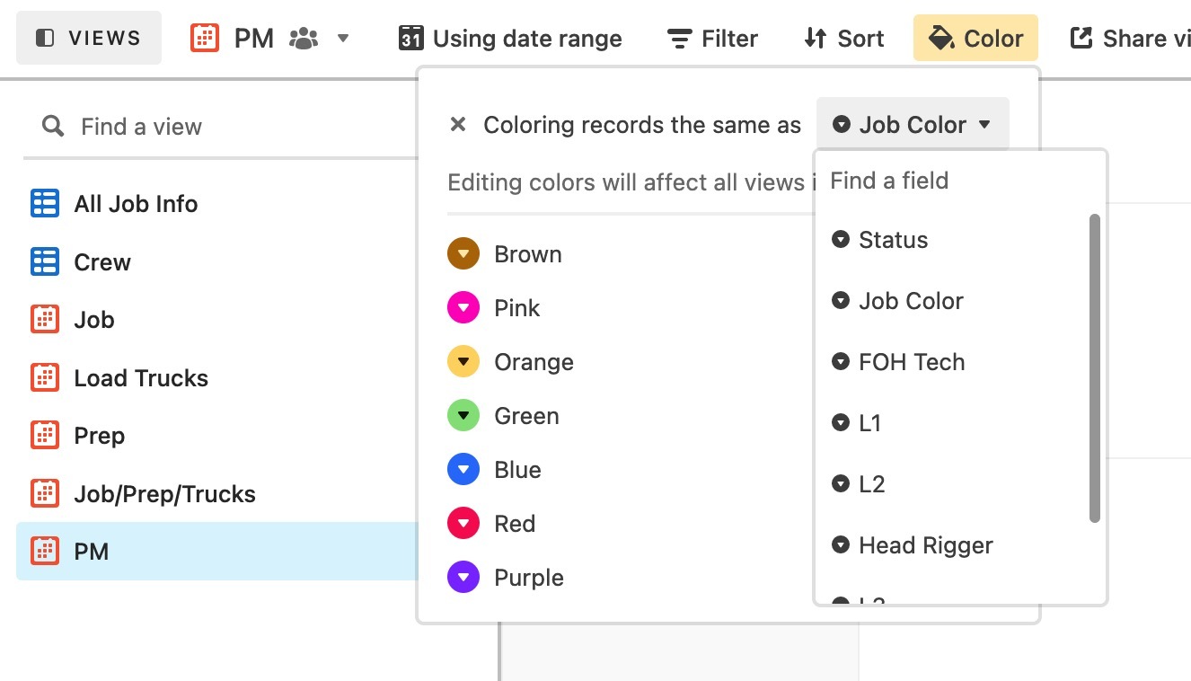

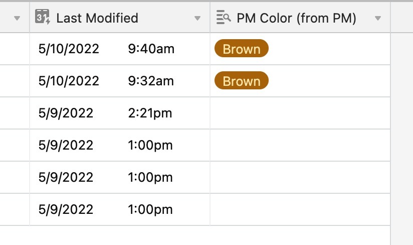

Hi
I have a table with a lookup from another table in a grid view in which the result is Brown. When I go to the calendar view to select the field for the color, it’s not in the list of options.
Thank you!
6 replies
  • May 10, 2022 2:23 PM UTC
Yeah, Airtable’s lookup fields will convert your single-select field to an array, so you’ll have to manually create all of your coloring criteria from scratch.
You may want to bring up this issue to support@airtable.com, so hopefully they can improve this behavior in the future.
