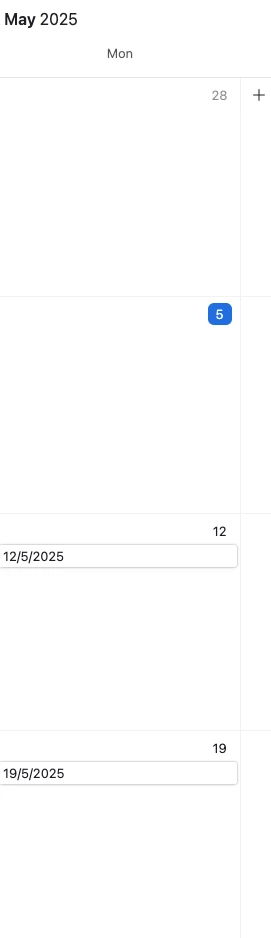

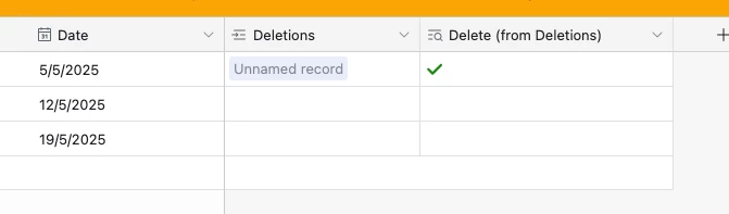

As a workaround, what if you:
  1. Create a new shared form with two fields: linked field to the original table and a ‘Delete’ checkbox
  2. In the original table, create a lookup field for the ‘Delete’ checkbox
  3. In the original table’s Calendar view, filter out any records with a ‘Delete’ checkbox ticked
And I’ve set it up here for you to check out
