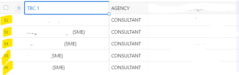

I am creating a budget balance sheet for the global payouts and because some budget lines are TBC I need to show certain fields within this set field so the formulas show accurate savings.
For example, I want to show Row 52-56 under TBC. How can I can work around this?
