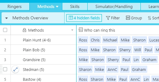

Here is part of my Base, where I define a simple Link to another Table.
However, I would also like to display only those linked names where a Checkbox has been set on the linked record.
How would I do that?
Graham

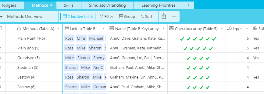

While viewing Table A (below) I can produce an array of record names (from Table B) and a matching array of Checkbox values
Again, while viewing Table A, can I manipulate these arrays (using a formula) to produce a new, filtered array containing only those Table B record names where the Checkbox field is True?.

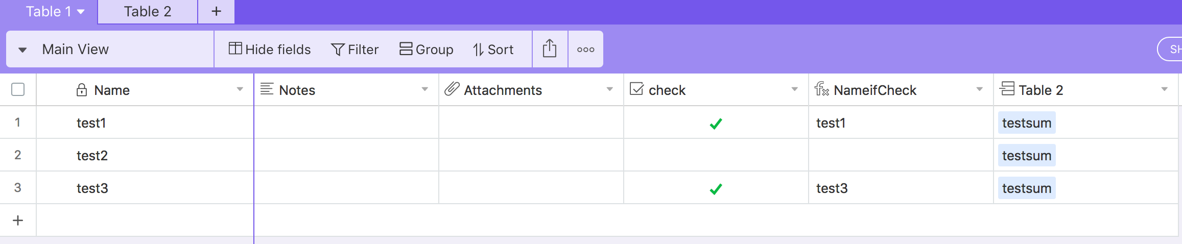

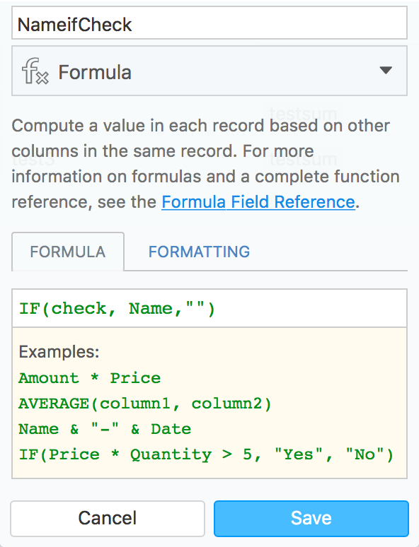

Table with names:
Where NameifChek field is calculated like this:

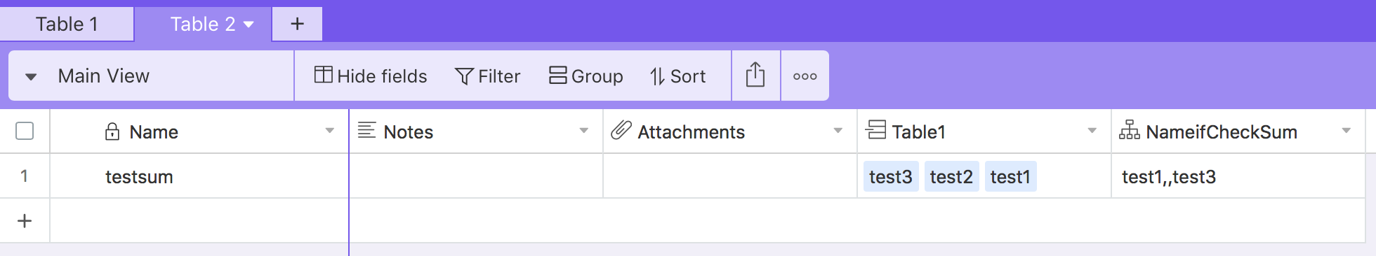

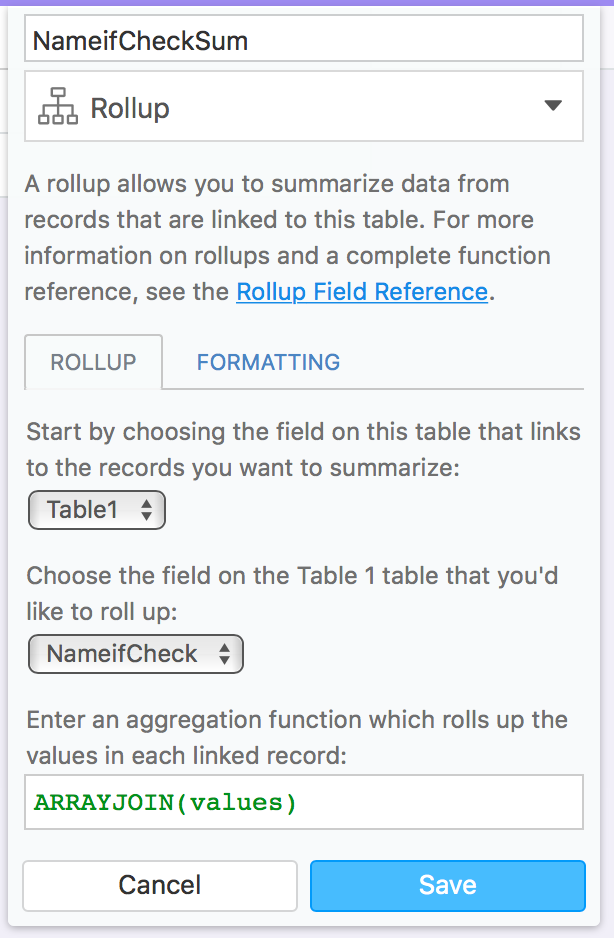

Here is a table associated with the names of:
Where the field NameifCheckSum is calculated:
  • February 24, 2017
Thanks @Kira_Lapin for that very clear explanation.
This is very neat.
It took me a while to get everything in the right place, but now it works perfectly.
