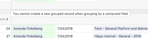

W_Vann-- any idea how to get around this? I’m making a time card view
  • Jul 25, 2018 7:13 PM UTC
Um… don’t group by a computed field?
This is one of Airtable’s extremely clever and helpful features except when it isn’t. In brief, when you create a new record from within a grouped view, Airtable automatically sets the value of the grouped-by field relative to the point in the view at which you created the record.¹ (It does something similar when you add a record from a filtered view.) The problem comes when you are grouping based on a computed field, as Airtable can’t really reverse engineer the calculation to determine how multiple values should be set. You’ll either have to find a way to group based on some sort of data field — for instance, assuming you are grouping based on the date range calculation, you could instead group on {WeekNum} — or use your grouped view only for data display and enter data on a non-grouped view.
  1. I hope that was somewhat comprehensible, because I can’t think of a better way to phrase it at the moment.
