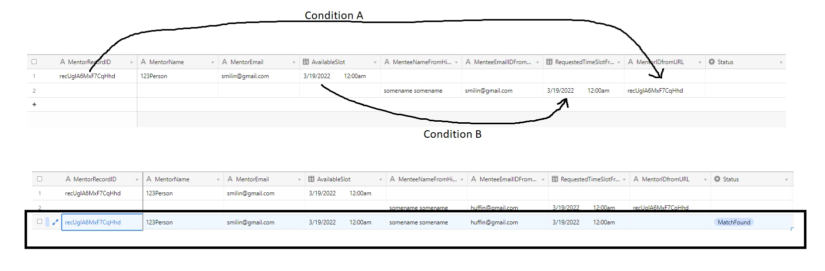

Thanks a bunch @Mohamed_Swellam and @ScottWorld for the swift response. I believe I missed out a couple of details and samples. I have tried to get the response from both (mentor and mentee) forms in one table. The only pending part is setting up a way to ensure:
When Condition A and Condition B is met, then CREATE a new row with the details AND SET STATUS to MATCHFOUND
Reference image below:
What I have tried:
  1. I tried creating views but it doesnt have dynamic filters to check for date column or MentorIDfromURL column
  2. I tried creating “Automation” but it also doesnt have dynamic filters for a column name and requires static values.
So none of the above helped .
Can you please help me with this piece? :pray:

That is exactly what needs scripting. Basically each record is its own data and you cannot link them except with a script .
