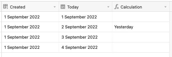

Hi Sharon, yeah, I feel like using DATETIME_DIFF might not be the way to go here. Don’t get me wrong, totally doable, but thinking about all the edge cases around that made my head hurt
If I were you, I think I would use a formula to check whether the created date matched yesterday’s date instead, and I’ve attached the formula below
  DATEADD(Today, '-1', 'days')
  DATETIME_PARSE(
    DATETIME_FORMAT(
      Created,
      'DD MM YYYY'
    'DD MM YYYY'
  "Yesterday"
And here’s a link to the base
The base has the Today field set up as a date field purely so that we can see the formula at work
  DATETIME_PARSE(
    DATETIME_FORMAT(
      Created,
      'DD MM YYYY'
    'DD MM YYYY'
  "Yesterday"
Thanks @Adam_TheTimeSavingCo - works perfectly!
