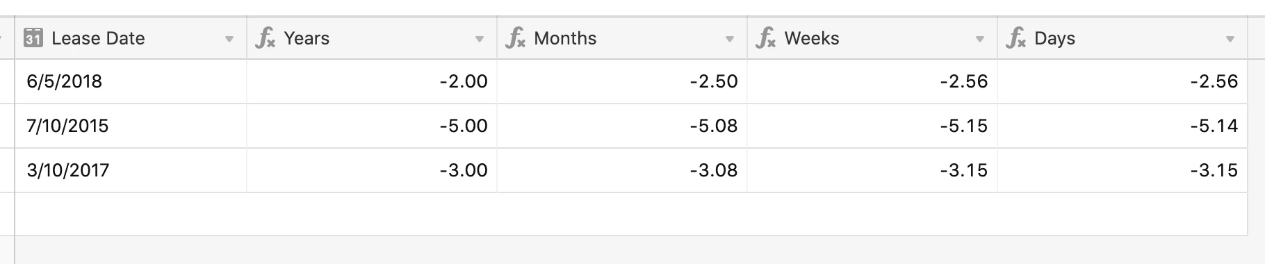

Hi @Alex_Everest - the DATETIME_DIFF formulas only give results in whole numbers (of whatever unit you’ve chosen), so even when you select a format of decimal with 2dp, you get “.00” at the end. You could try this:
Use a smaller unit, then divide by the number of that unit in a year. So for example “weeks” is:
DATETIME_DIFF({Lease Date}, TODAY(), 'weeks')/52

Worked perfectly, thanks @JonathanBowen
