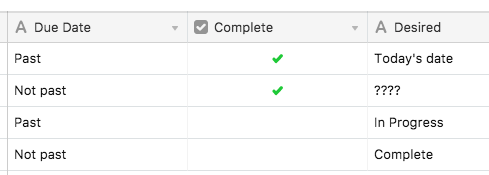

I have this options:
What happens if is not before, and is completed?
The formula
I don’t understand your statues, but here it is, as working in my demo table:
	IS_BEFORE(
		Date,
		TODAY()
		Complete,
		DATETIME_FORMAT(
			TODAY(),
			'll'
		'In Progress'
		Complete,
		'Complete'
Oh, I think you don’t need the AND() function, but it works like this: AND(logical1, [logical2, ...]).
Anyway, you can change the returning string to whatever you want, but that is the structure for 2 options and its 4 possible variations.
