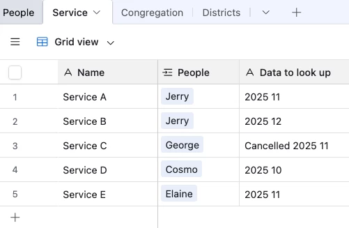

I’ve set something up here for you to check out!  I made some assumptions about how your data’s laid out that might be in error, and if that’s the case if you could provide some screenshots of your tables I’ll see what I can do!
Data:
(I’m using generic names for the services to make the example clearer)

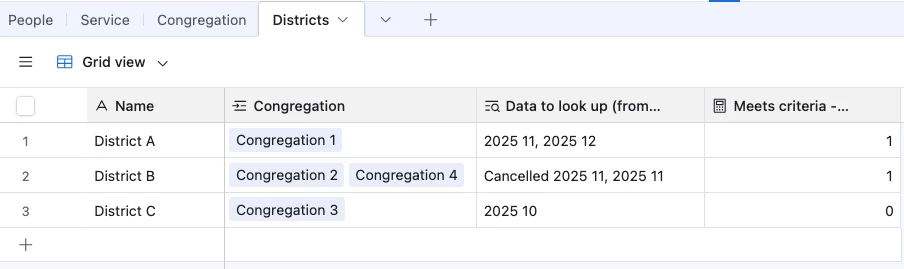

And we then use lookups to pull the data that we want to filter by over like so into Districts:

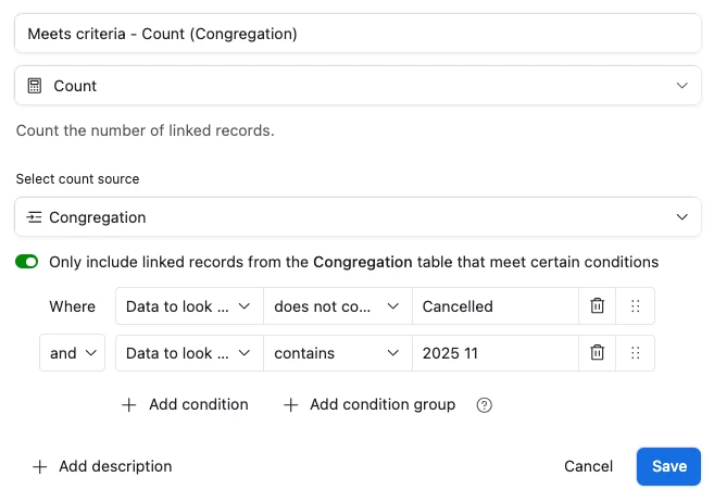

This setup then allows us to use a Count field to show which Districts had at least one service that meets the criteria you mentioned:
  1. Service contains “2025 11”
  2. Service does not contain “Cancelled”
And the count field’s conditional filters look like this:
Data:
