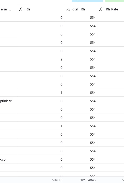

​ I have followed this to a tee but I am missing something here!
I have a table called Certified Partner Data (CPD). It is essentially my Main table from the exercise above. I have a field called TRIs in that CPD Table. I need to rollup the sum of that column.
I have created a Calc table and made it Link to CPD. I see all of records of CPD in one row of Calc.
I go back to CPD and create a Lookup field going back to the rollup in Calc of the TRIs.
Below is what I see when I when I view CPD. I have it filtered to a single month and you can see the TRIs column = 15 (column total at bottom) yes my Total TRIs is showing 554. That is the total NON FILTERED. The filtering on CPD has no effect on the Calc results. I am SO close but can’t seem to get this part to work. I am filtering on a Single Select “Month”. Why is it not picking up the Filtering from CPD? And as always, thank you!

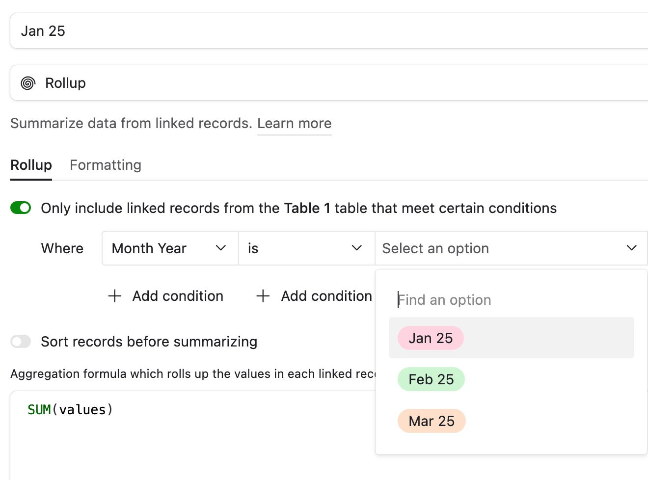

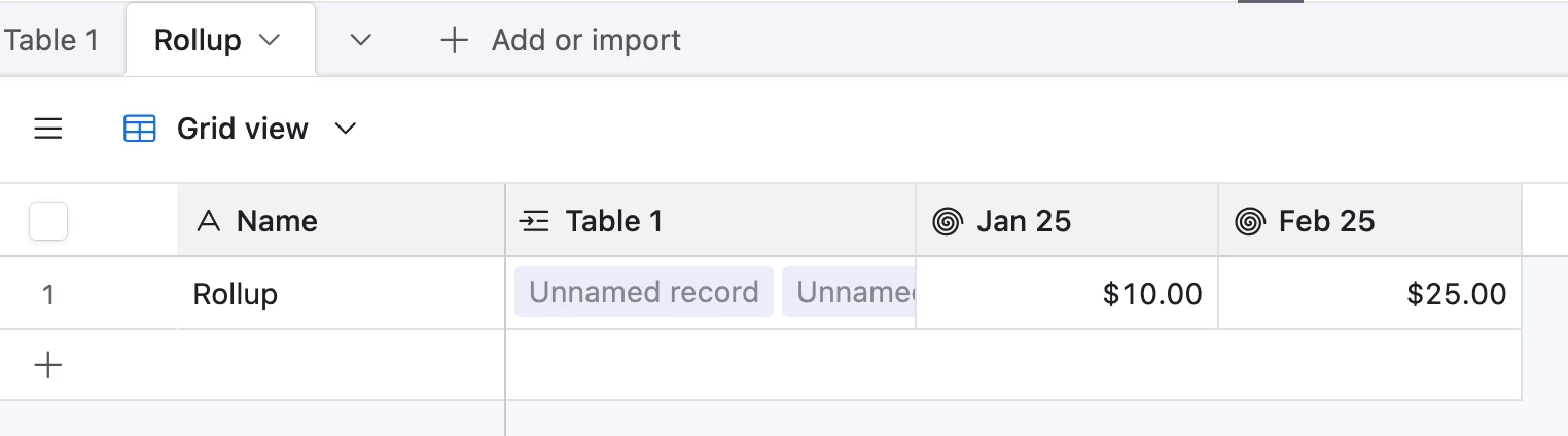

Yeah unfortunately filters on your main table don’t affect the rolled up data I’m afraid.  To get monthly data like the way you want, you can try either of the following options and I’ve set it them up here for you to check out
  1. Creating one field per month year and using conditional filtering to handle it:
    Resulting in:
  2. Creating a table where each record represents a month year value, and you’d populate this via an automation
    1. The idea would be to have a formula field that outputs the Month Year value e.g. Jan 25, and have an automation paste that value into a linked field to that new table.  How it triggers depends on how your data’s created though, for example if it’s from a form submission then you'd use the ‘On form submit’ trigger etc

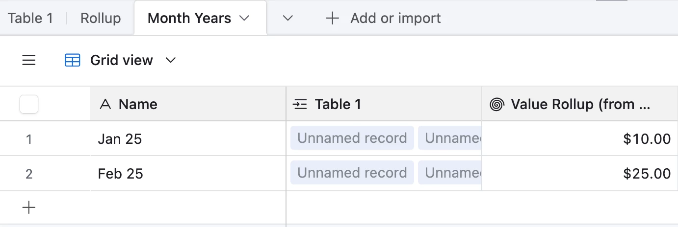

Hey ​@Jon_Eynon,
As discussed on today’s call, I would highly recommend you have a Reporting table (similar to what you intended with the Calcs table) but where each record would be a specific month. As you link your submissions (automatically ideally) to your Report records, you can have rollups to show the Sum() of the Hours, TIRs, and DARTs.
Screenshot below should help! For last, you can create interfaces to visualize this data in different ways.
If our call helped, and the above makes sense, please make sure to mark this answer as the correct solution :D
