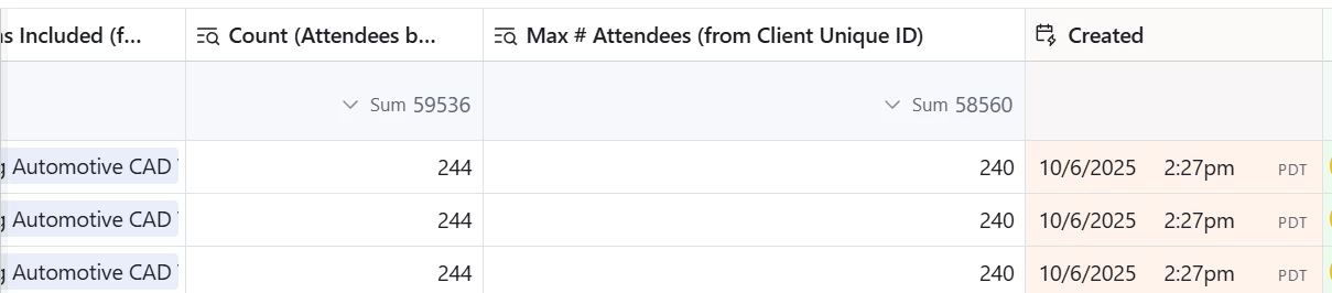

So I was thinking in the attendees table, where the form is linked to, I could have a view that first is sorted by date created.  Then, there are lookup fields from the table with the event info(linked to the attendee table), of count of attendees, and max # attendees.
I was thinking that there should be a way to have a view using these three things together, to only show those 240, in this case, based on first come first serve.  Does that make sense?

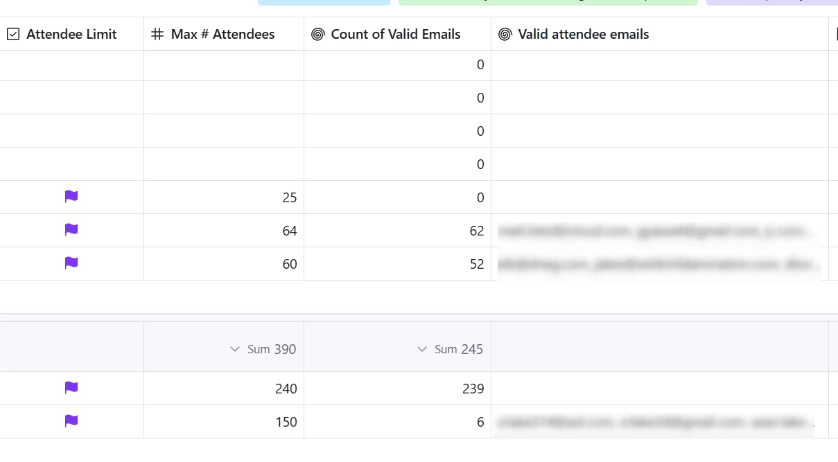

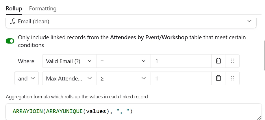

I think I may have solved it.  Instead of trying for a “view” in the origin table, the attendee table where the form sends its initial data, I opted to put a condition in the emails that are loaded based on #max-total(so far):
Sean_Lake1
Forum|alt.badge.img+20
  • Oct 7, 2025 7:51 PM UTC
So it will limit the number based on that condition.  My only concern is, are they sorted in that Valid attendee emails based on the date, alphabetically, or?
