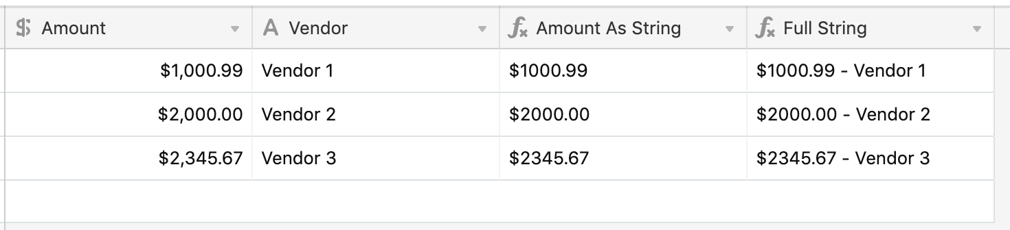

@Cady_Smith1 - I can get to this (but without the comma separator):
Amount as String:
'$' & IF(FIND('.', '' & Amount), '' & Amount, '' & Amount & '.00')
Full String:
{Amount As String} & ' - ' & Vendor
I’m sure there is a way to add the comma too, but you need to account for different scenarios (1k, 1m etc). Based on the length of the value string then insert a comma 6 places from the right etc. Not immediately obvious how you do this, but I’m sure it could be done, although formulas a bit complicated - wonder if you can get away without it?
