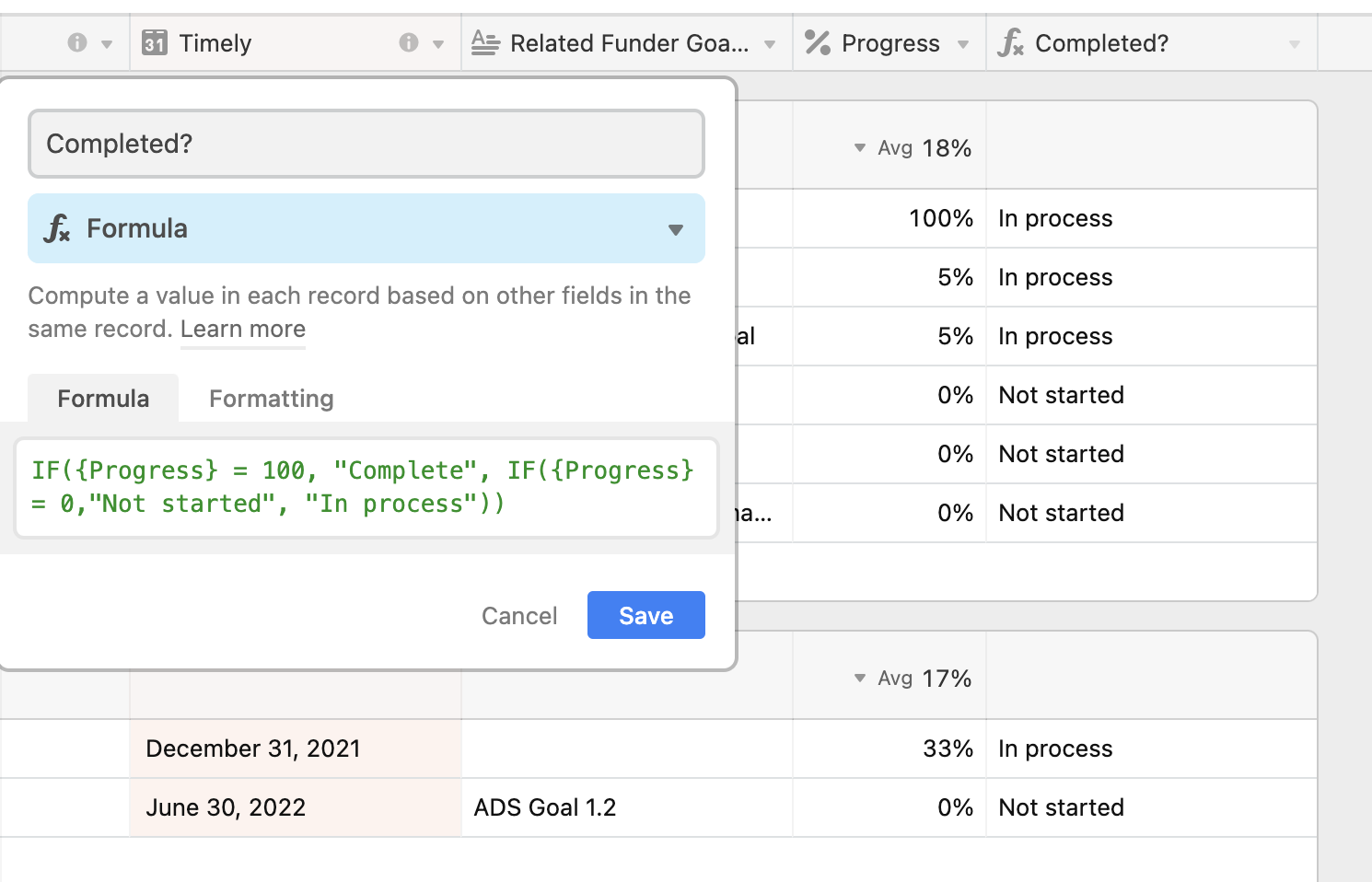

Hi everyone,
I’m looking to create a Field where I can mark tasks as either “Complete”, “In progress”, or “Not started” based on the Percent Complete I have manually entered in another field.
I’m using this formula, and it’s working for everything except Complete:
IF({Progress} = 100, “Complete”, IF({Progress} = 0,“Not started”, “In process”))
I’m also including a screenshot. What am I doing wrong?
Thanks!
Mica
Percent fields are stored as decimal values. So 100% isn’t 100 its 1.0. Therefore your formula should be:
SWITCH(
   {Progress},
   1, "Complete",
   0, "Not started",
   "In process"
or the following if you want to stick with nested IF()s
IF({Progress} = 1, "Complete",
IF({Progress} = 0, "Not started", "In process"))

Amazing, thank you!!!
