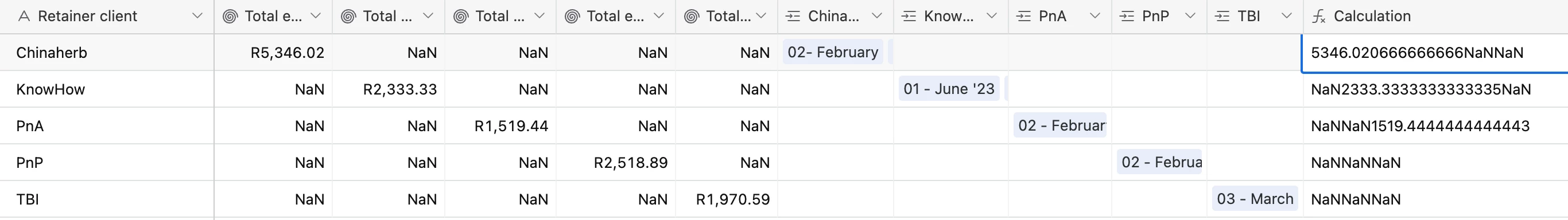

I know this is an old thread but I have a similar question (I think). I am trying to collate information from a whole lot of tables and rollups into one column as an average of the values. In order to do that, I need the information from 5 columns that are all formulas (columns B,C,D,E,F on screenshot) to show in column 'G' (Total average expenses). Is there a way to do this that doesn't include the NaN values?
