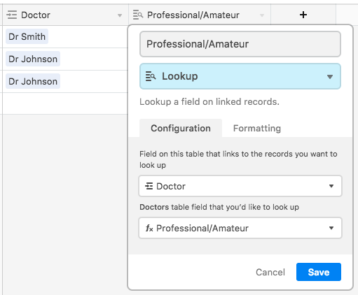

In that case, I would put the formula field into your [Doctors] table. Name it something like {Professional/Amateur}, and use this formula:
IF({Link to Major}, "Professional", "Amateur")
Replace {Link to Major} with the name of your field that links to the [Major] table. This formula will mark each doctor’s record appropriately based on whether or not they have any links to that table.
In any other table that links to a doctor, like it sounds your [Tasks] table does, you can look up that professional/amateur status with a Lookup field:
