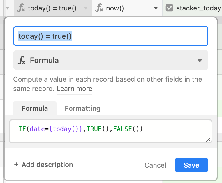

Hi all,
I have this formula IF(date={today()},TRUE(),FALSE())
when…

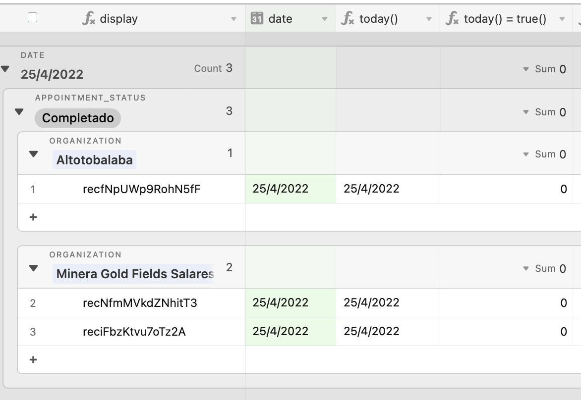

As you can see the column today() = true() doesn’t mark as true() even though they are the same.
thanks in advance

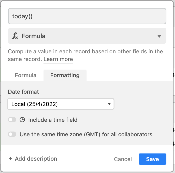

When working with dates, I recommend using date functions for comparison. In this case, I recommend using something like
IS_SAME({date}, TODAY(), 'day')
You may also have timezone issues.
