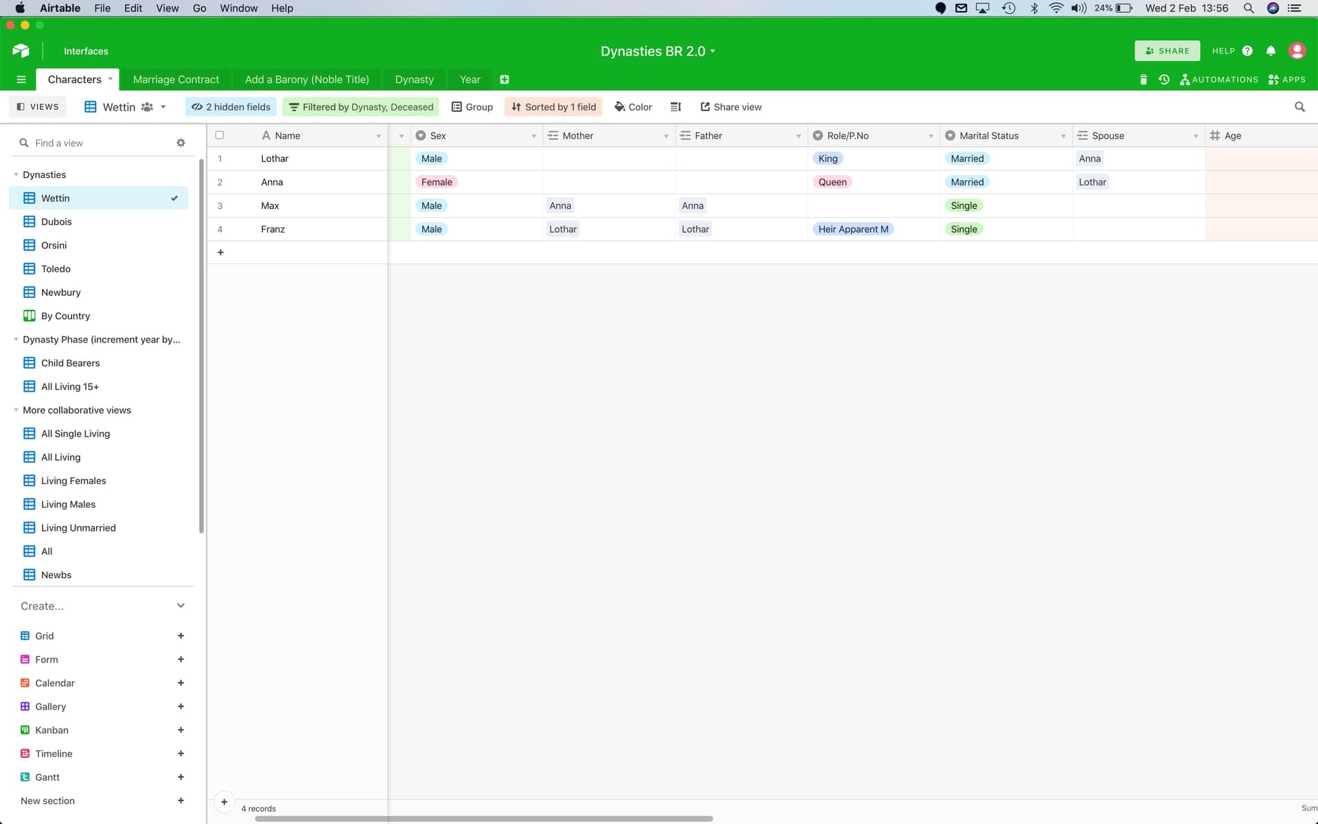

The screen capture shows that there is no record where both {Mother} and {Spouse} have a value. Thus, it make sense that scripting is showing a value for {Mother}, but no value for {Spouse}.
Do you want to create a new character where the selected record will become the {Mother} of the new character, and the {Spouse} of the selected record will become the {Father}? If so, that requires very different logic from what your code currently does.
While you might need to learn the difference between getCellValue versus getCellValueAsString, you have a bigger issue in the logic of how your code works versus what you want to do.

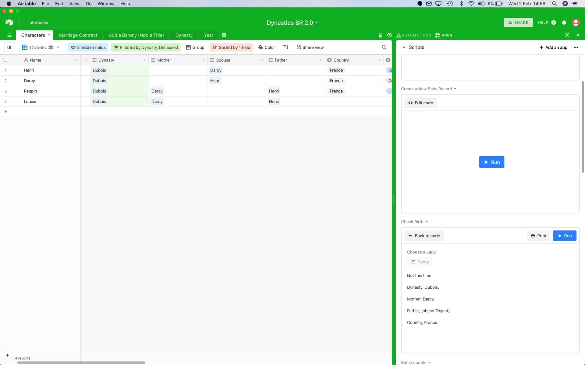

Am I confusing the issue between father and spouse? I want to read the contnets of the spouse feild into the variable fatherNow
I’ve slightyl altered the output code for clarity
dynastyNow = record.getCellValueAsString(“Dynasty”)
motherNow = record.getCellValueAsString(“Name”)
fatherNow = record.getCellValue(“Spouse”)
countryNow = record.getCellValueAsString(“Country”)
output.text(Dynasty, ${dynastyNow}.);
output.text(Mother, ${motherNow}.);
output.text(Father, ${fatherNow}.);
output.text(Country, ${countryNow}.);
And a clearer screenshot
When this is run on the record Dacry I dont understadn why fatherNow doesn’t end up containing ‘Henri’ from Darci’s spouse feild?
Your latest screenshot helps a ton. Your earlier description made it sound like you weren’t getting anything, but you’re actually getting the correct data for that field when using getCellValue, which is an array of objects. If you want the literal text of that linked record, use “getCellValueAsString” and you’ll see “Henri”
To clarify a bit more, when using getCellValue, you’re asking for the literal value stored for a field. For a single line or long text field, that’s already going to be text. For a linked record field, though, it’s going to be an array of objects, with each object containing the ID of a linked record; e.g. {id: "recXXXXXXXXXXXXXX"}. If you use output.text to display an object, though, all you’ll get is object Object for each one (the surrounding square braces are the array structure).
If the stored data isn’t already a string (as in this case) and you want to use/display it as a string, then you should use getCellValueAsString.
For more on the type of data returned for each field type, open the “API” section of the docs at the bottom of the script editor and read through the “Cell values and field options” section, or go here to open it separately:
