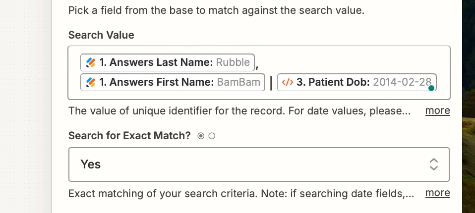

Hello all,
We have an automation set up through Zapier that searches for a record and updates the record if it finds it and creates a new one if it doesn't. The problem I am having is that duplicate records are being created that match the search criteria. I am unsure why and where to look for the issue (Work Flow: Jot Form to Zapier to Airtable).
Additionally, if anyone has a fix for a dupe record created because there is an extra space in the field (where and how can I strip it out or make it part of the search criteria)

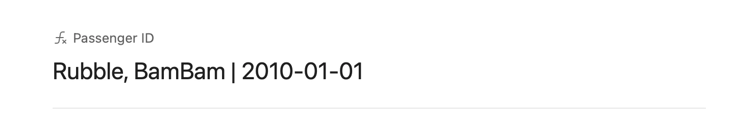

Attached are my search criteria (with a fictional test person) in Zapier and the ID in Airtable.
Thanks for any suggestions.

Thanks for the Reply Saravanan!
I did not set up the Zap just troubleshooting it but it has only recently been creating dupes of exact matches and nothing has changed so I'm at a loss. I am learning a lot but not super Zapier savvy yet. There is a unique search criteria and I believe the Find or Create setting is set up correctly. I looked at the logs and didn't see the same step repeated. I will look in to the formatter app for the spaces. Thanks.
I am not familiar with the Formatter App. I will look it.

Thanks for your reply. I have been finding the dupes because I use the dedupe extension and I am seeing them. I did a little research, see below. It may be difficult to show you all the data because The flow goes from Jot Form to Zapier into Airtable. There are a lot of fields. According to what I can tell, Zapier is set up with the right parameters and the find/create is set up properly. I am stumped on where to search.
Since 8/15 there have been 12 entries:
8 have exact match for First Name, Last Name, DOB
2 have an extra space
1 has cap vs lower case
1 did not dupe.
