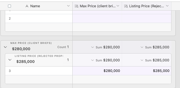

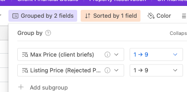

On this view,
I need to create groupings based on the Max Price and Listing Price.
The amount should match, but when I tried to do the grouping it did not show the correct numbers.
here's the current setup.
Here's the outcome.
The Max Price Should be $280k but why is it that the Listing Price of $285k was included on this group which supposedly was not?

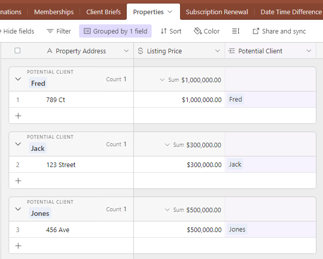

Hey @Imee_Lee ! I think I've got an alternate solution for you. Recorded a Loom Video here to walk you through step by step 🙂
Essentially this is an automation that will link your Hit List Clients to your Rejected Properties, based on the Property Listing Price, and their Min/Max Purchase Budget. I'll show you my example here:
*** REMEMBER TO UPDATE ALL TABLE / FIELD / VARIABLE NAMES TO MATCH YOURS ***
Sample Base Setup:
Desired Output - Properties are now grouped by Hit List Clients that land in price range.
Automation Setup:
Script Input Variables:
Script:
// get property table var propertyTable = base.getTable("Properties"); // get client table var clientTable = base.getTable("Client Briefs"); var clientQuery = await clientTable.selectRecordsAsync({fields: ["Client", "Min Purchase", "Max Purchase"]}) var clientRecords = clientQuery.records; // get input variables var inputConfig = input.config(); // get properties input variables var recordID = inputConfig.recordID; var listingPrice = inputConfig.listingPrice; var potentialClient = []; for (var i = 0; i < clientRecords.length; i++) { if (listingPrice >= clientRecords[i].getCellValue("Min Purchase") && listingPrice <= clientRecords[i].getCellValue("Max Purchase") ) { potentialClient.push(clientRecords[i]) } } console.log(potentialClient) // Update Potential Client Record var updates = [{ "id": recordID, fields: { "Potential Client": potentialClient } }] console.log(updates) await propertyTable.updateRecordsAsync(updates);
Last thought : remember that the trigger of "Enters A View" will only trigger when there is a state change and a new property ENTERS the view. This means that any properties ALREADY in the rejected properties view will NOT trigger the automation. One way to solve this is to trigger them manually (like I did in the video). Or alternatively you could temporarily remove them from the view and re-add them. This will trigger the automation.
Let me know if this worked for you!!

Alexey_Gusev
Forum|alt.badge.img+25
it's usual grouping work. Maybe you need some other function?. What is your desired output?
If you want to see records where Max Price=Listing Price, you should add formula field
Example:   IF({Max Price}={Listing Price},'Prices are equal')
and then filter by this field. And then maybe group, if you need
Arthur_Tutt
Hey @Imee_Lee ! Is this a follow up from your previous post? I've been meaning to get back to you. I still need a bit of clarification on what you're trying to achieve here. For example, let say you have a rejected property with a Listing Price of $500k, do you then want an output of all the clients that that falls within their budget (say Min $300k to max $600k)? If so I can test around some automation ideas to make that happen.
I don't believe what you're proposing in your question will work. If a record has a Max Price of $280k and a Listing Price of $285k, those values will never be equal and can't be grouped together, so I'm trying to think of alternate ways to achieve your objective here 🙂
Sample Base Setup:
Automation Setup:
Script:

Arthur_Tutt
Hey @Imee_Lee Great job implementing that solution so fast! I know it was a little complicated but you nailed it 😊.
And thanks for the follow up vid, I've got 2 thoughts for you:
Firstly, to achieve your objective, on line 19 of the script all you need to do is change ">="  to "==", which should look like:
if (listingPrice == clientRecords[i]...
HOWEVER - a word of caution. Using this method means that many properties will NEVER have an associated client. What I mean is that if the listing price is $197,000, no client will have their max budget match exactly that, they'd have $200,000.
So as long as you're cool that many properties will never be associated with a client, then fine, proceed. But in my opinion you'll be losing many connection opportunities (which is why I set to match in between min and max budgets). But hey it's your business, do as you like, I just want to give you the facts 🙂
