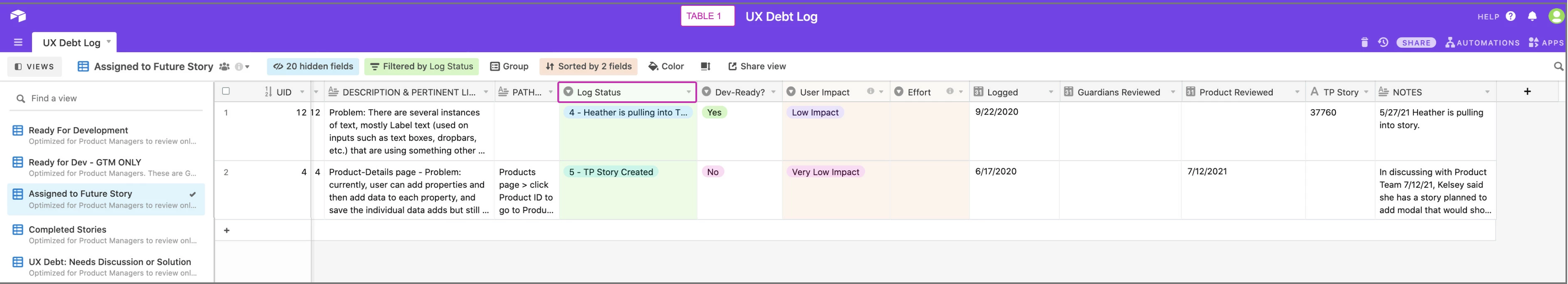

Table 1 is UX Debt Log.
It’s a table of UX-related items I’ve identified on our platform that need to be fixed/improved. The table has many columns. I have a Unique ID serving as the Primary Field and the records. I have many Views that equate to what stage the item is in and one of the key columns that help determine what view an item shows up on is Status. Table 1 views, based on Status, are as below:

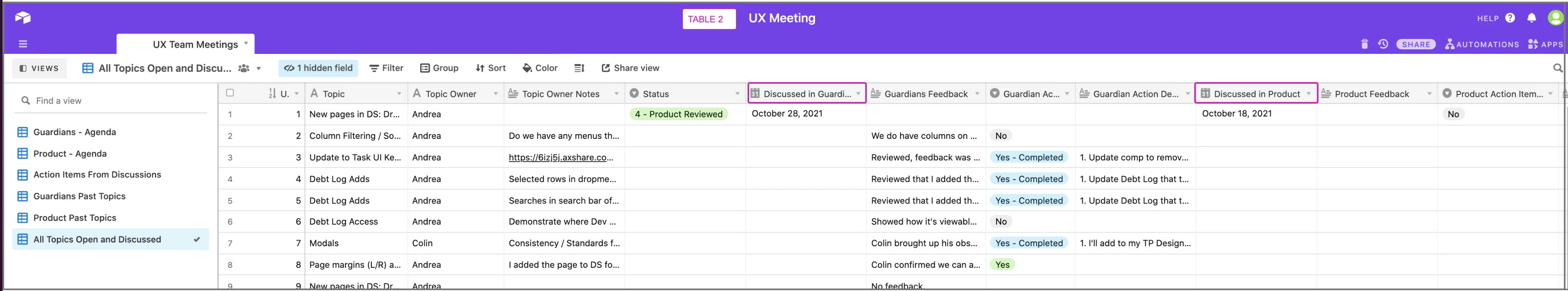

Table 2 is UX Meetings and consists of records made up of topics. The primary record is also a UID at the moment. The idea is that the topics that are moving through a series of discussions with two different groups and we want to track history of when they are discussed, feedback, etc. The typical process, though it can sometimes deviate or circle back, is that we discuss something with Group 1 first, then if approved, it moves forward to be discussed and approved in Group 2. Topics discussed might be a UX Debt item from Table 1, or might be something else. Thus, why I ended up with two tables.
Table 2 has many views, mostly based/filtered by “Status” column:

Snapshots of the two tables below. I edited the view names in above description for simplicity (for example, where in screenshot Table 2 shows Guardians Agenda - Guardians is what we call Group 1 so anywhere Guardians is referenced in columns and view names, it equates to Group 1). I also edited out extra tabs for other tables that were irrelvant, if you notice the purple area at top looks a bit off, lol.
