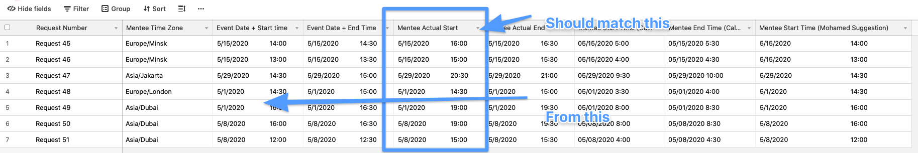

Hey there,
Wondering if you all can help me with a Timezone issue I’m having that’s driving me nuts! I think it’s to do with GMT/BST but I would like any help in solving this because I can’t get it right.
Trying to pair a Mentee and Mentor with each other, and they will live in different timezones, I can get the calendar invites to work, as it’s all based off nice and simple ISO time, but I can’t for the life of me get the timezone conversion to work in Airtable for local time (which I need for numerous other reasons related to communication)
I’m using this formula to convert the time as follows:
IF({Event Date + Start time}, DATETIME_FORMAT(SET_TIMEZONE(DATETIME_PARSE({Event Date + Start time}), {Mentor Timezone}), 'MM/DD/YYYY h:mm'),"")

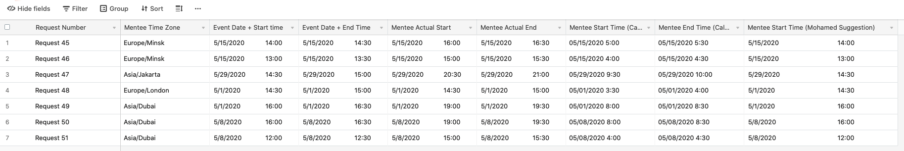

However, I’m getting a delta across Mentee and Mentor, as shown below in both tables:
Can one of you kind folk help me work out what’s going on?
Mentor View
Mentee View
As you can see, there are 6 columns in each, and the problem is that the Actual time differs from the Calculated time.
  • Event Date + Time - The ISO time that is converted to a calendar field
  • Actual - What the conversion should be
  • Calculated - What the conversion is when using the formula
Is this a bug or am I missing something?

Hey @Mohamed_Swellam - Thanks for getting back to me.
That’s actually where I started off, but that was so wildly out of sync with what I needed. The If statement only states (If there is a time - i.e. has a meeting been booked), and the Datetime parse was the last hope of a desperate man.
Regardless - I’ve added it in to the last column, above, and you can see that there’s a 2 hour difference between the start time, and your formula. I’d definitely appreciate if someone could point me in the right direction here.

Yep! I’m using that too! Can I see your solution, because I’ve added your solution to the table above, and you can see that there’s a 2 hour difference.
