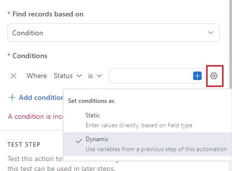

     - Add a condition for the Region field and turn this to dynamic
     - Click the blue plus icon and choose the Region field of your trigger record

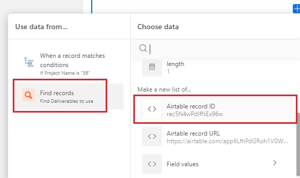

     - For fields, select the linked record field between your two tables and insert Find records -> Make a new list of Airtable record ID

Use a “Find records” action to find records in the other table. Use the gear icon to say you want to find records based on condition. Set the conditions based on the two fields that will have the same values. Make sure that options have exactly the same spelling, capitalization, white space, and punctuation. Test the action.
