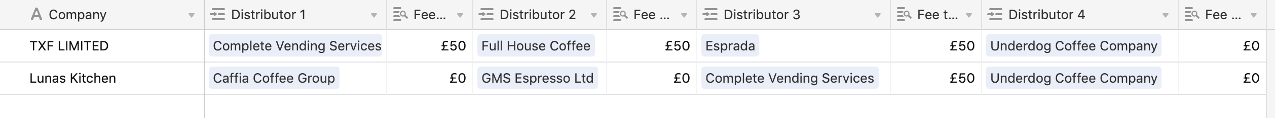

I run a company that sends qualified leads to hardware distributors.
Someone gets in touch with us via our site, and pass on their information to four distributors (out of several dozen, we pick the four best ones).
Every week, we invoice each distributor for the number of leads we’ve sent them.
So the records for a given week might look something like this
What I want to be able to produce, is a view that shows how many leads each distributor had, and how much they owe.
So from this view above, it should return:
Complete Vending Services | 2 Leads | £100
Full House Coffee | 1 Lead | £50
Esprada | 1 Lead | £50
Underdog Coffee Company | 2 Leads | £0
Caffia Coffee Group | 1 Lead | £0
GMS ESpresso Ltd | 1 Lead | £0
Help?

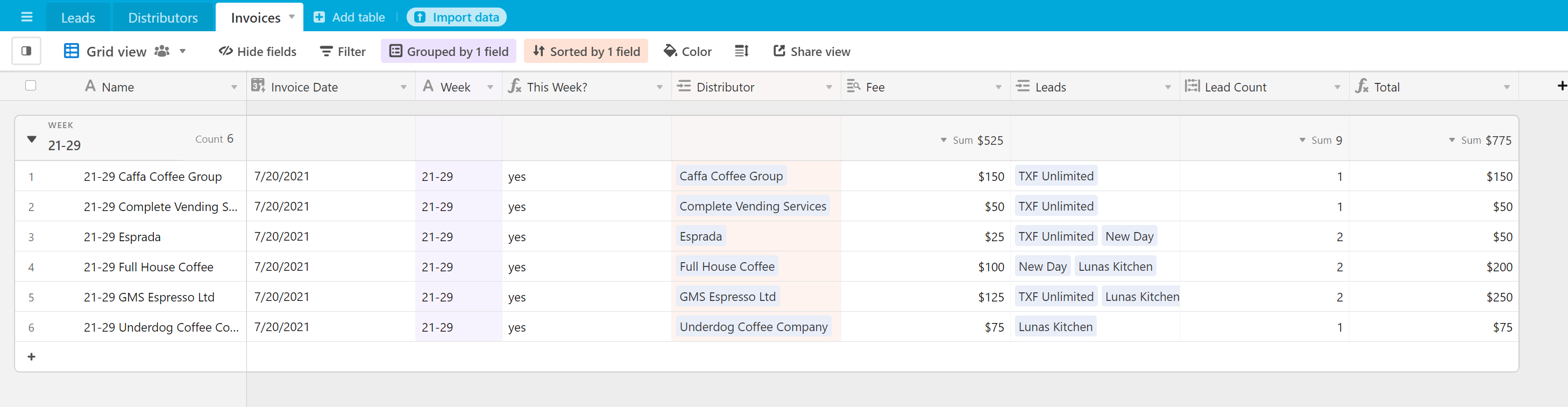

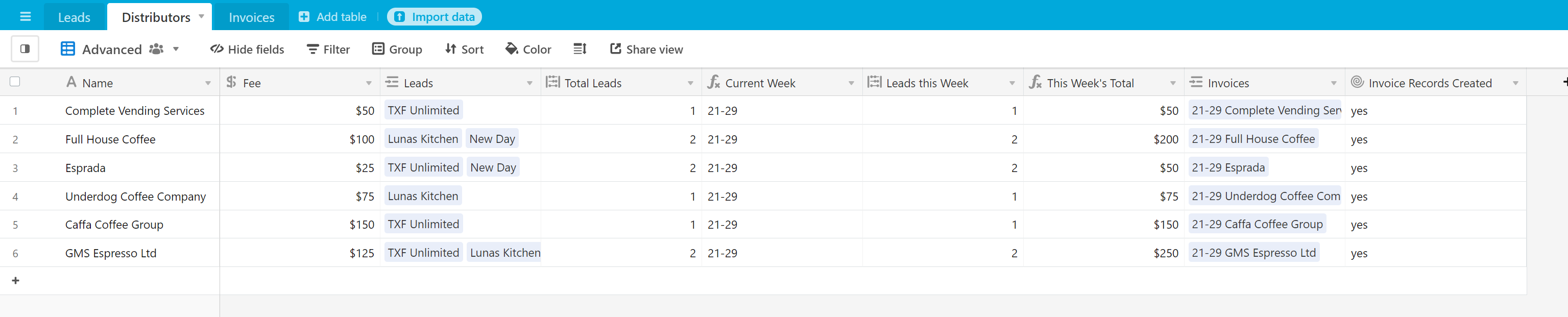

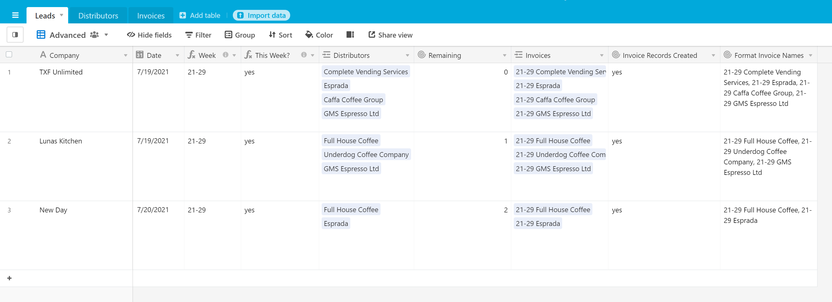

The instructions below will show each distributor’s owed fees for the current week, and will reset with each new week as time goes by.
[Leads] table
  • A date field
  • A formula field to calculate the week the lead should be invoiced for, based on the date field.
    IF(Date, DATETIME_FORMAT(Date, "YY-WW"))
  • A formula field to determine if this lead is from “this week”
    IF(Week = DATETIME_FORMAT(TODAY(), "YY-WW"), "yes", "no")
  • One link to the [Distributors] table, as opposed to 4 like in your current setup. This helps to prevent duplicate linking
  • (optional) A rollup field to let you know how many more distributors could/should be linked.
    Target field: {Name}
    Aggregation formula: 4 - COUNTALL(values)
  • (optional) a count field for all [Leads] records linked to the distributor
  • A count field to calculate the number of leads from this week
    Condition: {This Week?} is "yes"
  • A Formula field to calculate the fees owed this week
    {Leads this Week} * Fee
Advanced Solution (no scripting)
The instructions below assume you’ve done all of the above instructions, and have a separate [Invoices] table to keep a log of each week’s owed amounts by distributor. A less complicated version of these instructions could be made using scripting.
[Invoices] table
  • A field for the week
  • A formula field to determine if this invoice is for “this week”
  • A link to the [Distributors] table
  • A lookup of the distributor’s fee
  • A link to the [Leads] table
  • A count field, pointing at the linked [Leads] records
  • A formula field multiplying the number of leads by the distributor’s fee
    {Fee} * {Lead Count}
  • A formula field to calculate the current week
  • A link to the [Invoices] table
  • A rollup field determining if an [Invoice] record has been created for this week for this distributor, assuming this distributor has been linked to a lead (otherwise there’s nothing to bill for, and no invoice is needed).
    Target field: {This Week?}
    Aggregation formula: IF(AND(COUNTA(values) > 0, {Leads this Week} > 0), "yes", "no")
[Leads] table
  • A rollup that determines if the necessary invoice records for all distributors have been created yet.
    Target field: {Invoice Records Created}
    Aggregation formula: IF(ARRAYUNIQUE(values) = "yes", "yes", "no")
  • A rollup field to calculate the names of the [Invoice] records to link to.
    Aggregation formula: IF(AND(values, {Week}, {Invoice Records Created} = "yes"), {Week} & " " & ARRAYJOIN(values, ", " & {Week} & " "))
Automation 1: Create Invoice Records
  • Trigger:
    Type: When record matches conditions
    Table: Distributors
    Conditions: {Leads this Week} > 0
  • Step 1: Create record
    Table: Invoices
    Fields:
    • {Name}: [Trigger record > field value > {Current Week}] (space) [Trigger record > field value > {Name}]
    • {Distributor}: [Trigger record > field value > {Name}]
    • {Week}: [Trigger record > field value > {Current Week}]
Automation 2: Link Invoices
  • Trigger:
    Type: When record is updated
    Table: Leads
    Fields: {Format Invoice Names}
  • Step 1: Update record
    Table: Leads
    Record Id: [Trigger record > record ID]
    Fields:
    • {Invoices}: [Trigger record > field value > {Format Invoice Names}]
