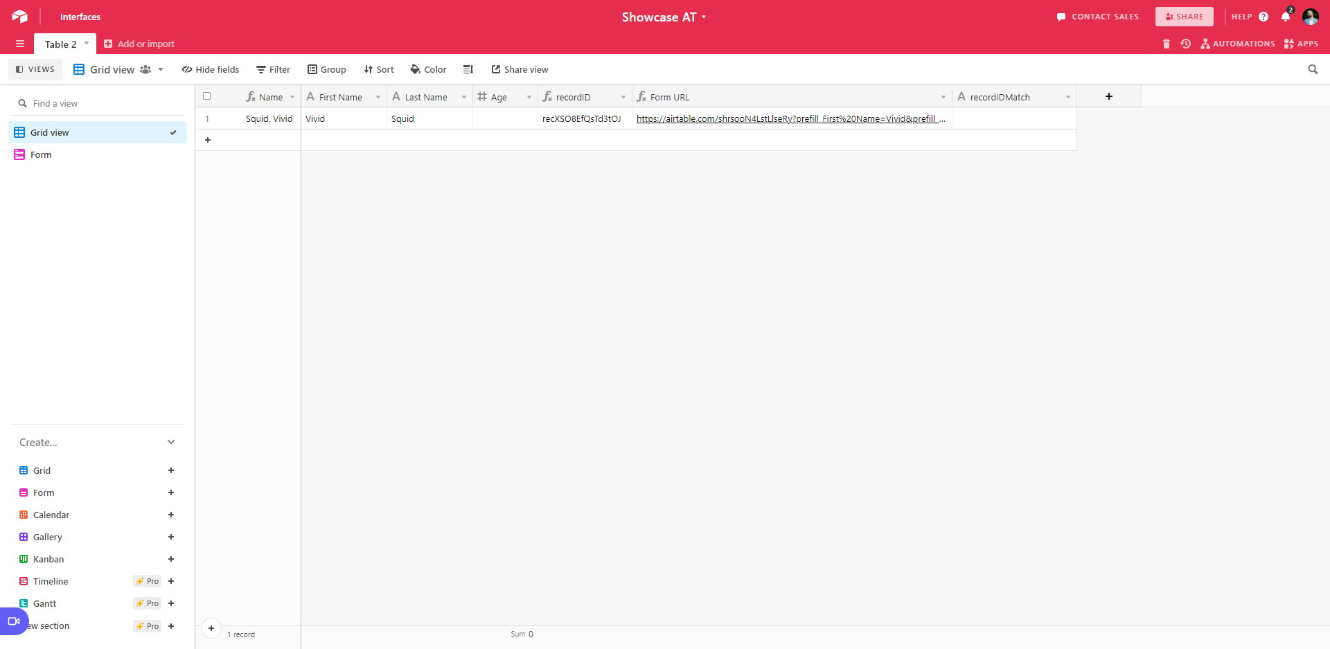

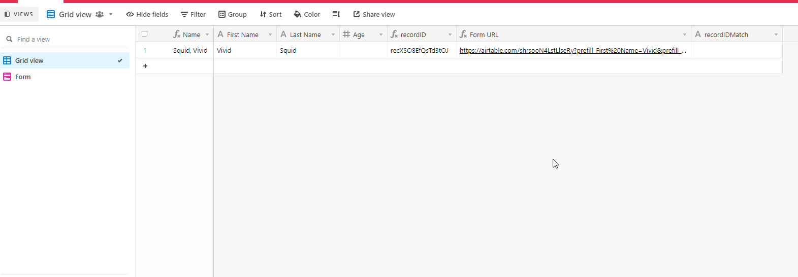

Here I have a table with a person that is missing a detail, in this case Age
I have added a few extra fields:
  1. a formula field with the formula: record_ID() this gives me the unique id of that row
  2. a formula field that creates a form URL (using the Prefilled Forms app in the marketplace) I created this formula
"https://airtable.com/shrsooN4LstLlseRy?" &
"prefill_First%20Name=" & ENCODE_URL_COMPONENT({First Name} & "")  & "&" &
"prefill_Last%20Name=" & ENCODE_URL_COMPONENT({Last Name} & "")  & "&" &
"prefill_Age=" & ENCODE_URL_COMPONENT({Age} & "")  & "&" &
"prefill_recordIDMatch=" & ENCODE_URL_COMPONENT({recordID} & "")  & "&" &"hide_recordIDMatch=true"
  1. A text field called recordIDMatch, this stays empty for now.
In the formula I am prefilling the form with the records I have and if I dont have it, it will just be blank for the person to add to the form. Importantly I am prefilling the recordIDMatch with the row’s ID.
Now I have a URL to send to each person (note: each row’s URL is unique to that person, so dont send it to the wrong person.
When the URL is opened in a browser, it will open the form, prefill with info I have and leave missing info blank. It will also add the recordID in the background, The user will not see this happen.

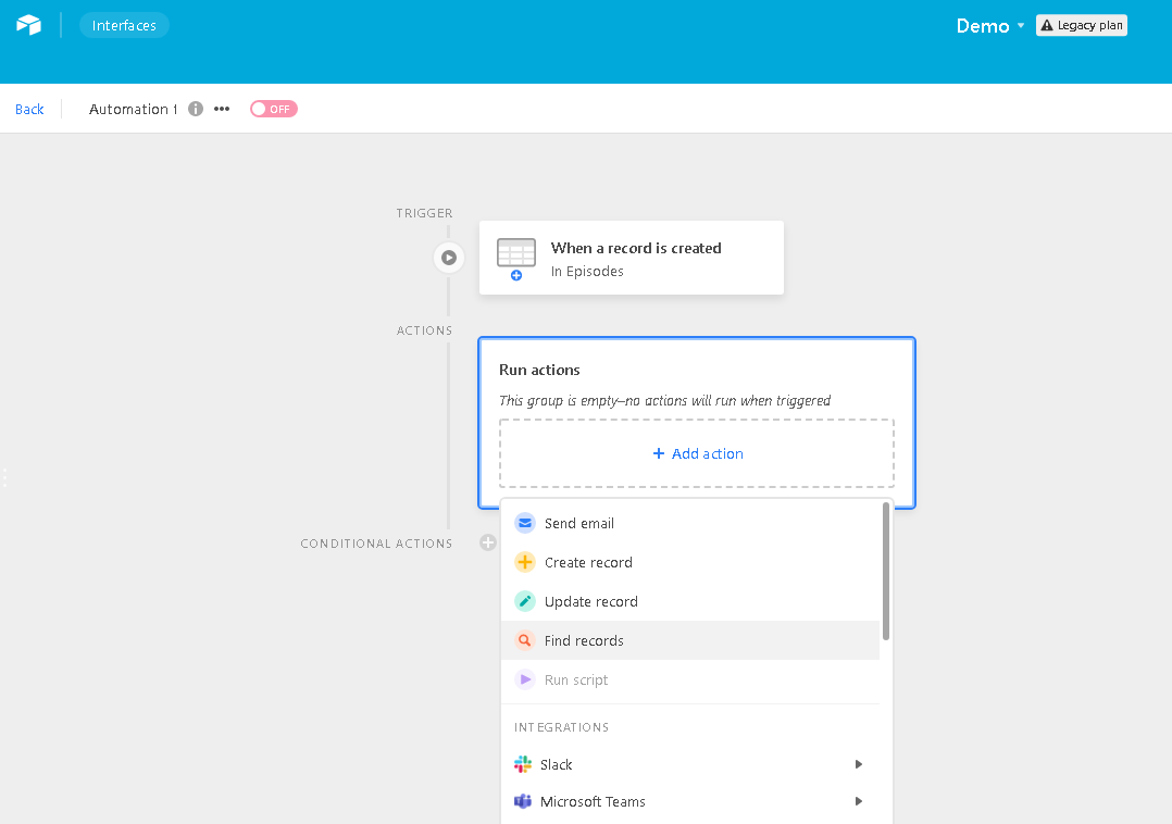

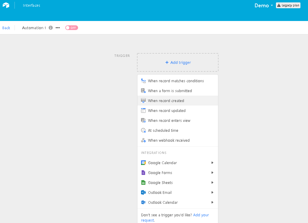

Now create your automation to update the record.
Trigger: when row is created

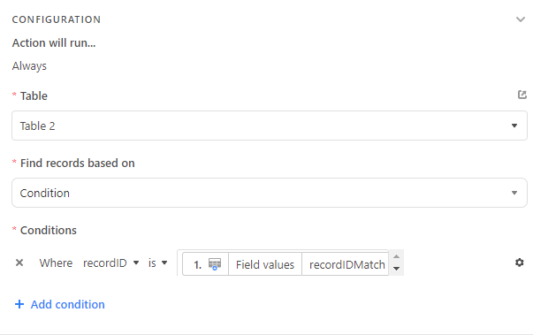

Action: Find Records where recordID is recordIDMatch

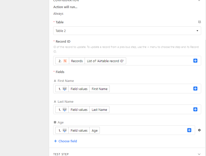

Action: Update Records we want to update the record found in step 1 and all other fields too.
This will let the person filling out the form correct any mistakes in the existing data too.

I can try to help.

I wanted to add my automation so that when the form is filled and the missing fields filled in and submitted it automatically updates the exsisting record.
So following your instructions above.
I cant find
I cant see how to add any of the actions.

These are the steps in an Automation setup
