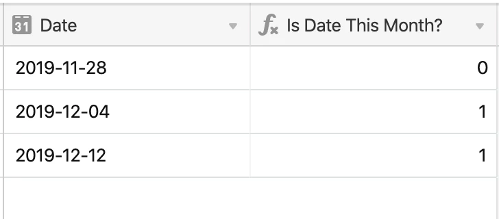

Hi @Alan_Mclaverty - try this:
The formula field is:
IF(Date >= DATETIME_PARSE(DATETIME_FORMAT(TODAY(), 'YYYY-MM-01')), 1, 0)
This shows “1” if the Date field is >= to 1st of “this month” and “0” otherwise. Each month, the 1st of the month “moves forward”, so this month this will evaluate to 1st Dec, next month, 1st Jan and so on. Now you can set up your filter to be where this field is “1”. If you don’t want to see this field, just hide it - it will still be available to your filter.
JB
