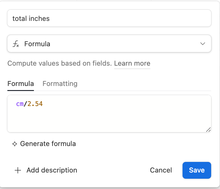

First, as you mentioned, you'll need to divide by 2.54 to convert to inches.

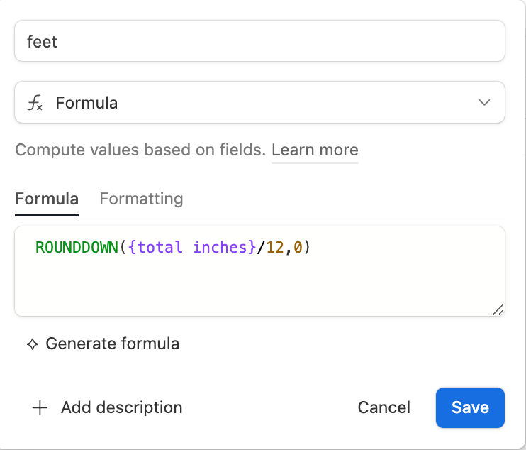

Then, you'll want a formula that divides by 12 to figure out how many feet and rounds down to the nearest foot.

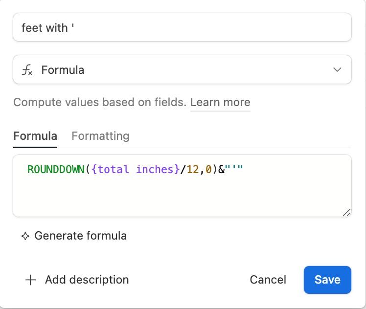

Then, you'll want a formula that adds the single quote for use in the final formula that formats the height in the desired way

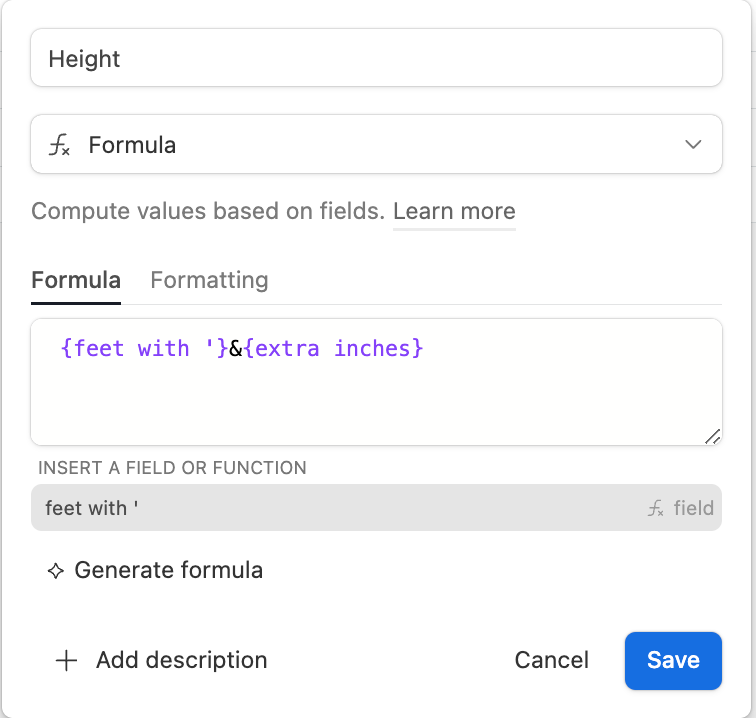

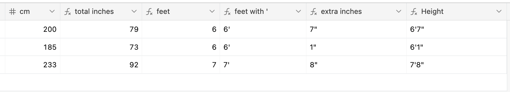

The final formula simply strings two elements from the other formula together to show the height in the desired format
