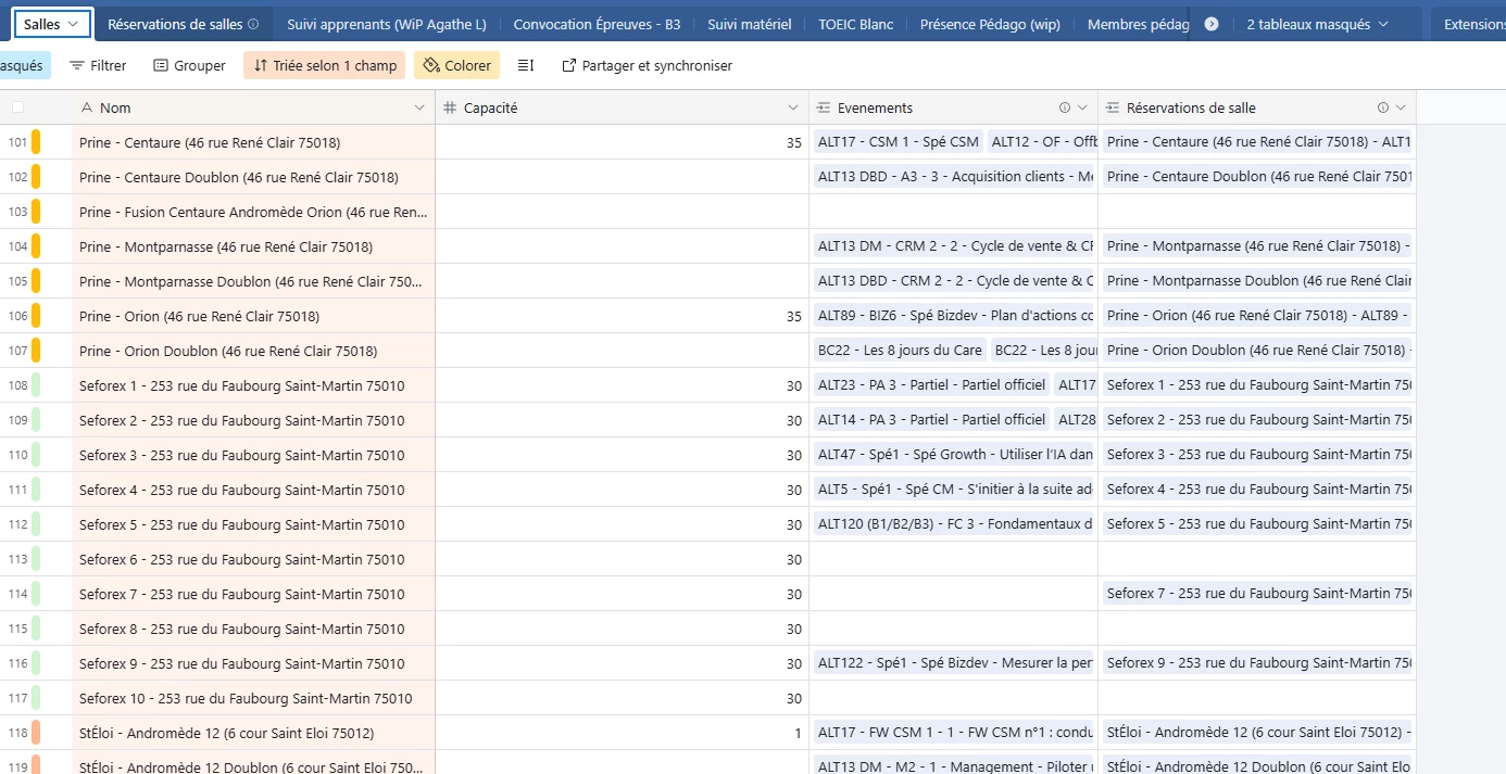

I work at a digital school and I would like to have an easy view where I can see all my classrooms whether they are booked with a course or not. I have a total of 20 classrooms.
I already have calendars where I can put the dates, the courses and the classrooms the courses will be taught in. In the calendar view, I also created a returning view telling me whether a classroom is already booked. I have a tab with all my classrooms and another one telling me if there’s an error due to booking the same classroom for two courses at the same time.
I also am able to create a view of all the classrooms that are booked but I don’t seem to be able to add the classrooms that are available. I’m sure there’s a way to add the empty classroom.

This is a​​​​​the classrooms lists

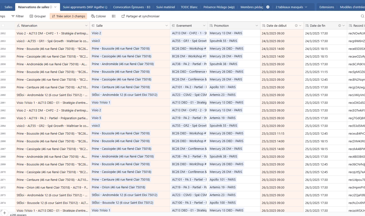

And this is the log of all the classrooms that were booked
Hey ​@Leo Lyuki,
1. Can classrooms only be booked on fixed schedules? E.g. 1hs periods Monday to Friday? Or is this really flexible?
If fixed, you will want to make sure that under Calendar table you have one record per slot per classroom. If there is a reservation for such slot (linked) the slot becomes Booked, otherwise the slot is Available. (you can handle this with an IF() formula).
So rather than looking at availability from the Classrooms tables, you would do that from the Calendar table -as my understanding is that you do not need to know whether right now the classroom is booked or available, but to see and find available sports in the future. Right?
