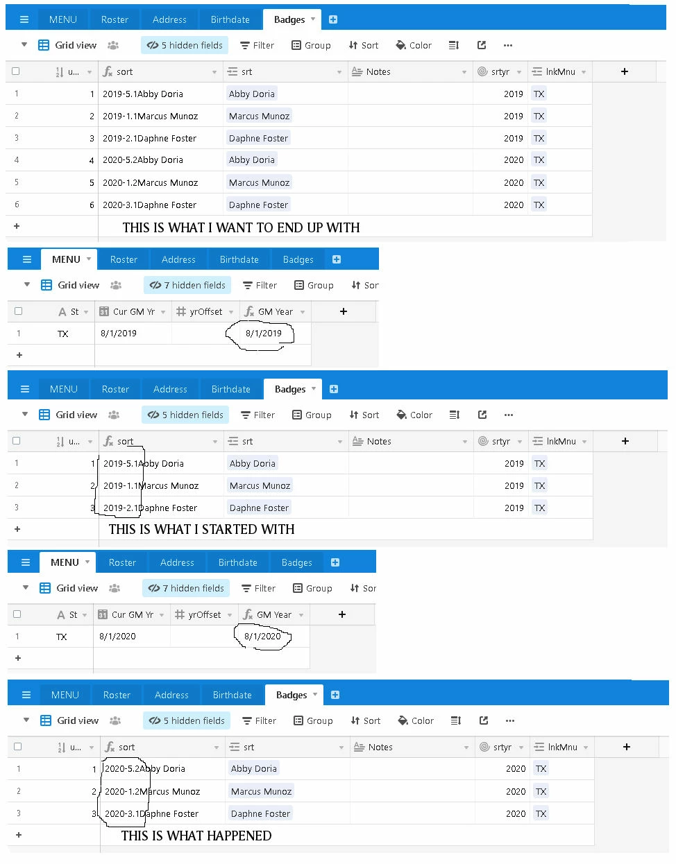

Since I’m new to this particular app, I may have done something wrong, but when the year is changed the year in the Badges record also changes.
I have 3 tables:
Main - contains 1 record which contains the date that is changed at the beginning of our club year
Member - contains a record for each member and each leader along with info like birthdate, grade, club, …
Badges - will contain a record for each member and for each year (i.e. Tina has a record for 2019 and one for 2020, …). The year, club code, and name are concatenated into Sort.
I decided to create a 2nd year (year2) field containing a formula with a test: if year2 is blank() then load year into it otherwise leave it alone. The formula has a format error so I know it’s not correct
IF(srt2=BLANK(),CONCATENATE(srtyr&cl),)
And I’m not even sure if the formula can test the field it is in. If not, maybe I can create another field that gets loaded with a value if year2 has a value.
Any suggestions on the best way to handle this?

  • Jul 24, 2020 1:16 PM UTC
Could you include some screen shots to make it easier to understand your situation?
However, formula fields and rollup fields might not work the way you want. They are always automatically calculated. It isn’t possible for a formula field to calculate a value, and then stop calculating it.
Airtable can have a button that will calculate a value and store that calculated value in a non-formula field. However, that requires Scripting Block, which will become a paid feature in September.
  • Jul 25, 2020 1:33 AM UTC
Here is the screen shot with certain places marked.
The name and club code came from Members; the date came from Menu.
  • Jul 25, 2020 5:22 PM UTC
How did you create the screen shot of what you want to end up with? Is it an actual screen shot, or did you manually create it by pasting together different images?
Because you are changing the date in the original record in the [MENU] table, this change gets propagated through the linked records and formulas. You cannot change this behavior. You need a different base design.
It is difficult to tell how you should change the base because your screen shots don’t show all of the relationships among the tables. However, one option to consider is to create a new record for each year, instead of changing the existing record.
  • Jul 28, 2020 3:30 PM UTC
Sorry I couldn’t respond sooner. My area was without power for awhile, then I had to do some major changes to a non-profit website I maintain.
I manually created the screenshots.
The lnkmenu field links to the menu database which contains one record containing TX and each record in Badges contains TX and the date is pulled from there. The srt field links to a record in the Member database and pulls the name and club. There is one record in Members potentially linked to several records in Badges. If I do use more than one record in Menu, should I sort it newest first or last or does it matter to the way it would function internally? The newest at the top would easiest for accessing.
Any other ideas or suggestions?
