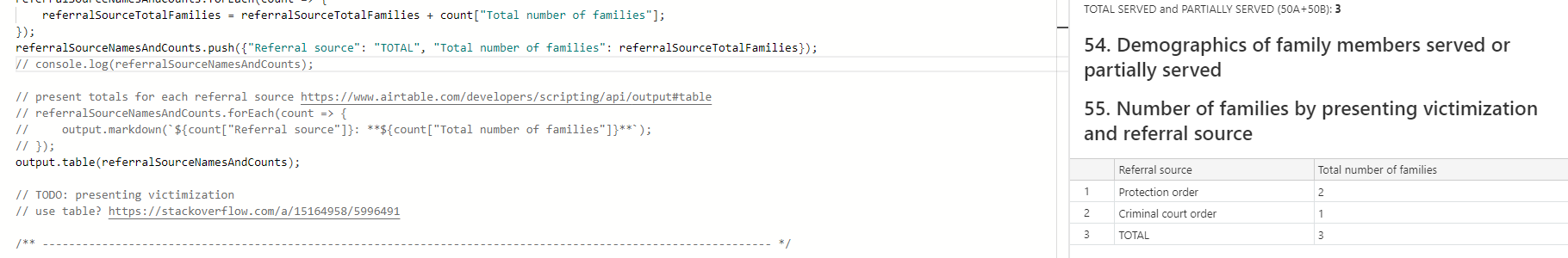

How would I remove the first column of output.table in the Scripting app?
  • Jul 22, 2021 5:34 PM UTC
  • 260 views
Here’s my use-case:
I want to remove the first column with the indices because I think they would confuse my client, who wants a very simple report presentation.
  • Jul 22, 2021 5:52 PM UTC
It is not possible to remove that first column. The output options for Scripting app are very limited.
  • Jul 22, 2021 6:45 PM UTC
The closest thing I can get is creating a custom object that “rephrases” the index value, per the console.table docs: console.table() - Web APIs | MDN
