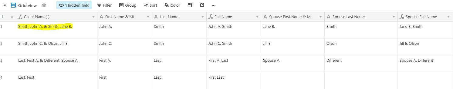

Jeremy!
Thank you for your help. This works for the most part, however the only problem I have now is when the last name of the Spouse is the same as the “Last Name” field.
How would I get it to be able to see that and react accordingly?
See the image below for reference.
I want it to be able to see that {Spouse Last Name}={Last Name} and then populate w/ {Last Name}, {First Name} & {Spouse First Name}.
Any assistance, guidance or suggestions are appreciated!

That would only require a small modification to @Jeremy_Oglesby’s original formula:
{Last Name} &
{First Name} &
    OR(
        {Spouse First Name},
        {Spouse Last Name}
    AND(
        {Spouse Last Name},
        {Spouse Last Name} != {Last Name}
    {Spouse Last Name} & ", "
{Spouse First Name}
