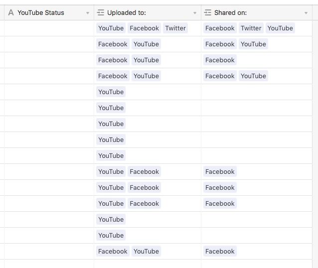

Hi all,
I’ve been racking my brains all morning trying to figure out a formula for a table and could do with some assistance!
What I’m hoping to achieve if a traffic light system. If a record isn’t uploaded to YouTube or shared on Youtube, the field displays a red emoji, if a record is uploaded but not shared, it displays an amber emoji and if the video is uploaded and shared, it displays a green emoji.
Can an IF statement be used across 2 fields? What I am essentially looking for is an IF Contains formula! I got a certain portion of the way to an answer however, my formula was only working if the ONLY value in a field was YouTube (i.e no Facebook, Twitter)
If anyone could offer any assistance, I would greatly appreciate it!

Thanks Elias, I’m afraid i’m still struggling. In your example, what would Condition 2 be; I’ve tried leaving it blank but unsurprisingly that didn’t work.
Sorry to be stupid! :slightly_smiling_face:

For YouTube, you could use
    FIND(
        'YouTube',
        {Uploaded to:}
        FIND(
            'YouTube',
            {Shared on:},
(I entered that without testing; I think I got the right number of parentheses in it.)
Essentially, it looks to see if it’s been uploaded; if not, it displays the red emoji. (Could it be shared but not uploaded? If so, I need to make a change.) If it has been uploaded, it looks to see if it’s been shared as well, if so, it displays the green emoji; otherwise, it shows the yellow.
