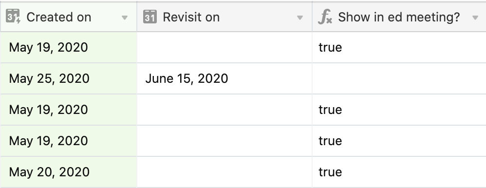

Thank you so much, this formula works – thanks also for telling me where I went wrong.
Do you know why the second record doesn’t return “true”? Since it should return “true” if it was created within the last week or if the “Revisit on” date is today:
Thanks again :slightly_smiling_face:

Good catch. You need to check if the created on date is greater than or equal to the TODAY, not just greater than. I edited my original formula with the fix.

This works, thank you sooo much!
