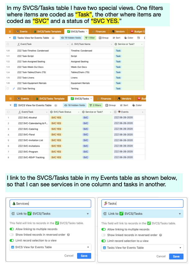

Greetings to the Airtable Community!
In my SVCS/Tasks table I have two special views. One filters where items are coded as “Task”, the other where items are coded as “SVC” and a status of “SVC YES.”

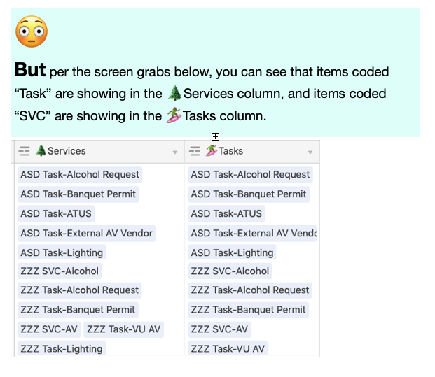

I link to the SVCS/Tasks table in my Events table, using the views above to “Limit record selection to a view.” One column to display the SVC items, the other the Tasks. This was working well, but now I’m seeing SVC items in the Task view and vice versa.
I’ve attached some screen grabs to demonstrate the issue. Any assistance/guidance would be most appreciated.

Hi @John_Dlouhy
Could you send screenshots of the actual filters?
The other question I have, is, did you link the correct record to the correct field? In other words, did a record get linked to the wrong field.

Hi Mary Kay!
Below are screen grabs of the filters. I’m 99.99345% certain I’m linked to the right field.

Your link limitation and filter setups look fine to me.
Is it possible that the links are being made in reverse; i.e. from the [SVCS/Tasks] table to the [Events] table, where there’s no restriction in place?
Has that link limitation always been in place since the base was first put into use? If the limitation was added later, that wouldn’t affect old errant links. The limitation only restricts what records are shown for selection when creating a link. It doesn’t change existing links made to records that wouldn’t currently appear because of the limitation.
Are all of these links being created manually from within the Airtable interface?

That could be the cause of the errant links. If there was no limitation in place for a certain period of time, it’s possible that links were made to the wrong type of item during that period.
Is this base only used by you, or are there others who work in it on occasion?
I was effectively asking if the links were made by a person using Airtable, vs some API-driven system (custom code, or an integration service like Zapier or Integromat) tweaking things. Here’s why I asked that: the link filters you added only work via the Airtable UI. If you have code tweaking the data via the API, that code can do whatever it wants because the link limitations don’t affect it.
I’m the only one working on it now. Hoping to roll it out to my team next week. Is there anything I can do to fix the errant links?

Just take them out one by one, leaving the proper ones for each field. The limitations should keep things in line going forward.
