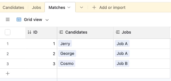

I’d suggest having these three tables instead:
  1. Candidates
  2. Jobs
  3. Matches, where each record represents a link between a Candidate and a Job
And the Matches table would look something like this:
