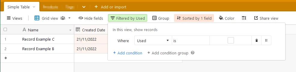

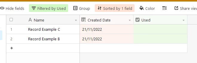

Within a Table, you’d have a Name Field, the “Created Date” automatic Field, and a Used Check-Box Field.
Filter the “Used” column to display unticked records;
And sort by Created Date field;
Keen to understand if this doesn’t work, what’s not working about it.
I think it hinges on whether or not the view should include only the oldest unused record. In your view, the user sees all the unused records with the oldest as the first in the list.
Karlstens
Forum|alt.badge.img+24
  • Nov 21, 2022 4:16 AM UTC
So for a View to only show the eldest record that’s not used, I’ll suggest adding one extra tick field called “Eldest Record”, and an Automation checks all records, and ticks the eldest record that meets the criteria.
