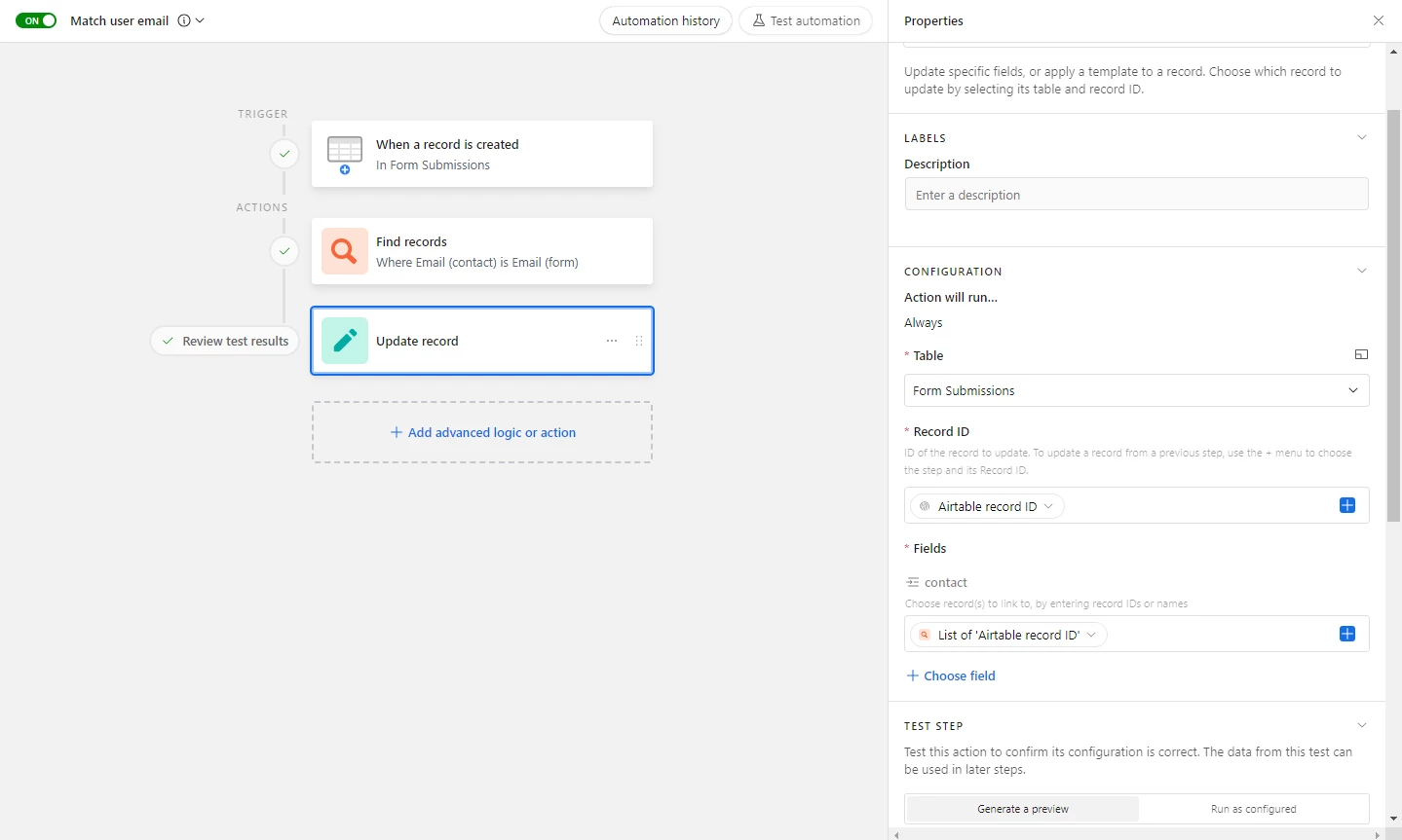

I have almost everything working, I'm just stuck on getting the automation to work for linking the submission email to a client in the client table. I've created the automation to find the record but I must have missed something because it's found the matching record but isn't linking them (screenshot showing what I've done).
Thank you so much for the help!
Interesting!  That looks like you've set it up correctly.  If you could provide a read-only invite link to a duplicated copy of your base with some example data I could take a look at this for you! https://support.airtable.com/docs/adding-a-base-collaborator#adding-a-base-collaborator-in-airtable
