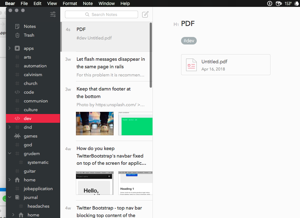

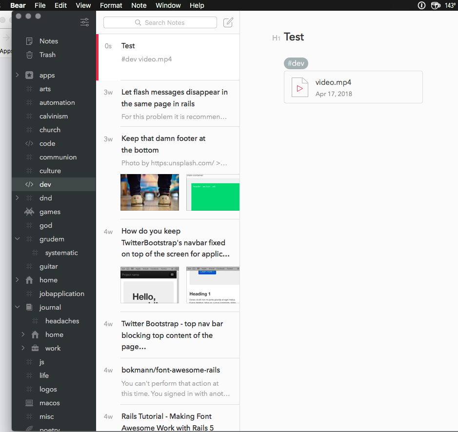

Bear allows you to drop a file of just about any type into a note. I created a note and dropped in an .mp4 file:

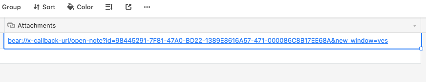

Then I could place a URL in Airtable to open that particular note in bear:
That URL opens Bear (or focuses it if it’s already open), passes it the ID of the note I want to see (which I got by cmd/2-finger clicking on the note in Bear and selecting “Copy Note ID”), and then opens that note in a new window.

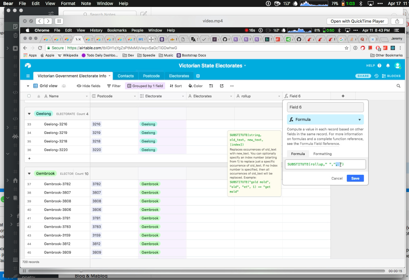

Since that note contains a Video file, I just double click on the video file displayed in the note - it opens in OS X’s preview player (I’m not sure if this plays sound or not, but there’s a button in the top right to open it in your default video player if you need that)(the video in the screenshot is a screen-recording of me doing something in Airtable, so it may look confusing, but you can see the play/pause controls in the bottom, and the QuickTime button in the top right):
Since you can drop pretty much any kind of file into Bear and it will create a link to preview the file, you could follow this pattern with any type of resource you need to link to from Airtable:
