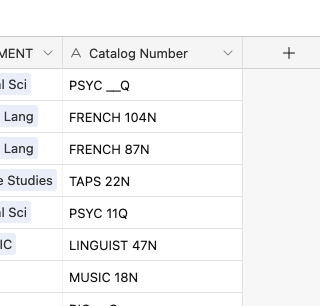

Another table is a course table called Courses AY25. The first column is a catalog number and the other columns contain course information.

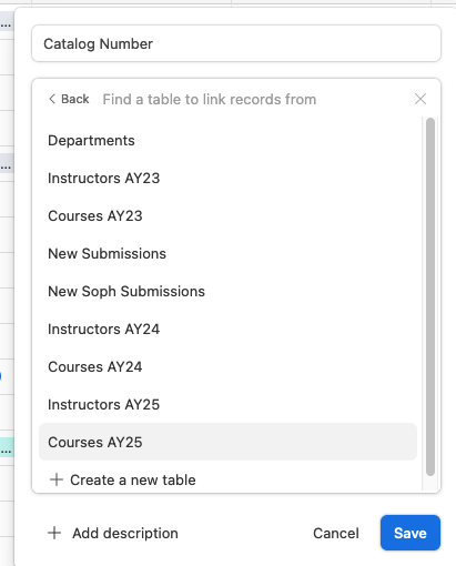

In the Instructor table, I have tried changing the catalog number to a linked field and linking it to the Course Table. This works and allows me to look up fields from the Course Table, but the new column that is created on the Course Table that should link back to the Instructor table is empty.
Here's the instructor table catalog number:
I have linked this to the course table:

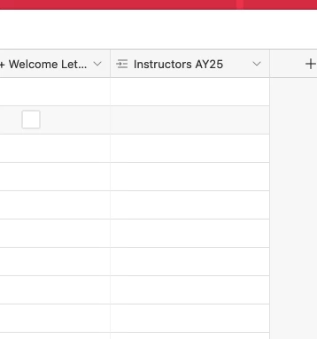

But the column it creates on the Courses table looks like this and is empty:
I want the instructor names to pull into this column.

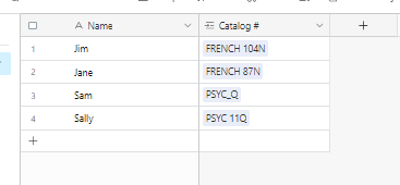

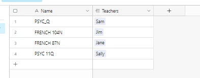

In this example I made both lists first in the first column of each table and then selected the Catalog # for each teacher.
Hope this helps a little!

Thank you both for your help! I found the error on my end and it was completely a user error. My catalog numbers in the Course table actually had a space at the end of each and so when I was trying to link from the Instructor table it was creating new rows at the bottom of the course table. Thanks again!
